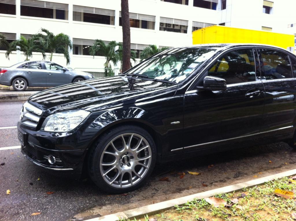

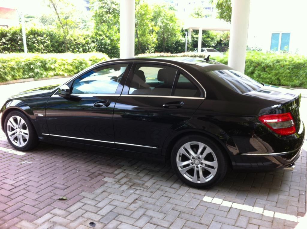

Personal observation : When I changed to 18", steering veeringleft was pretty obvious. When changed back to stock 17", the veering left was not so obvious. Did not do any alignment at all.
