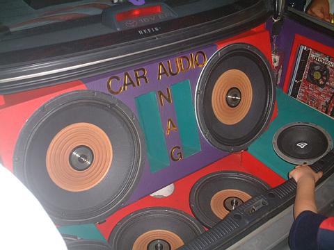

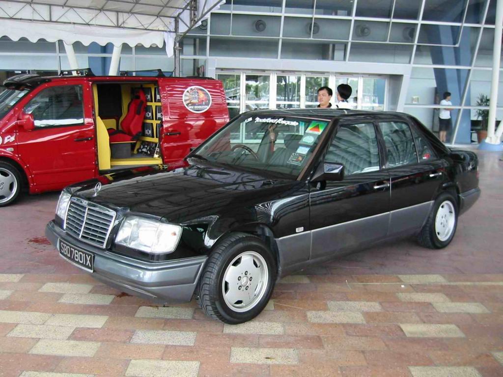

These 3 rides were at Yishun almost every sat nite and featured at one of the Auto Saloon at EXPO for SPL setups.....these 3 cars had to be outside the EXPO's halls.... :)
Unfortunately Season Audio Jason's W202 I do not have photos

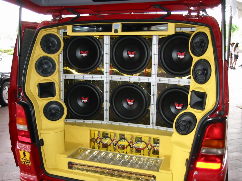

New Generation Cartoon aka Elson's Vito - SQ, SPL & Home Theatre
Zooms Audio Geoffrey's Vito- SQ & SPL

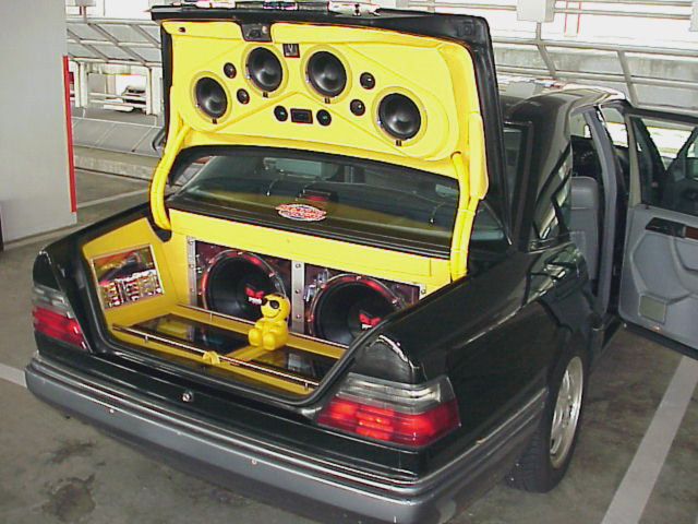

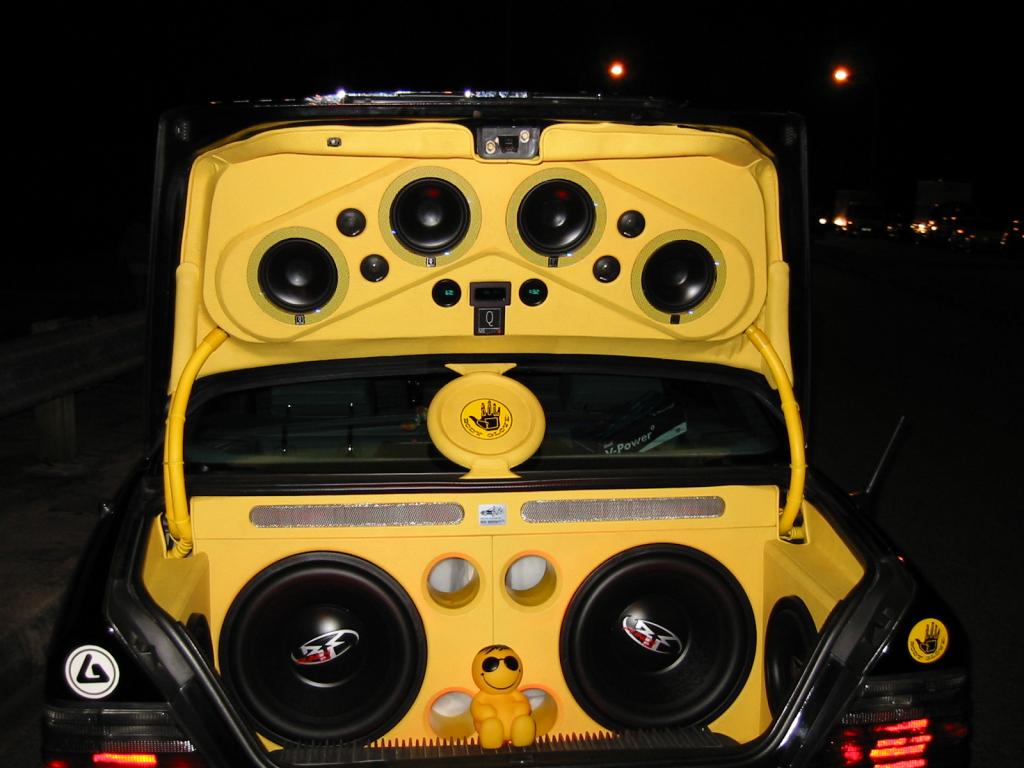

My W124 - SQ & Blasting
If you had been at Yishun, you will recognised this yellow sunglassed plastic doll mascot :)

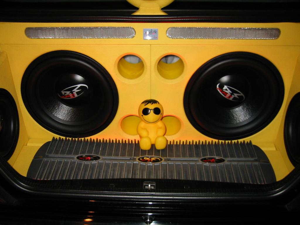

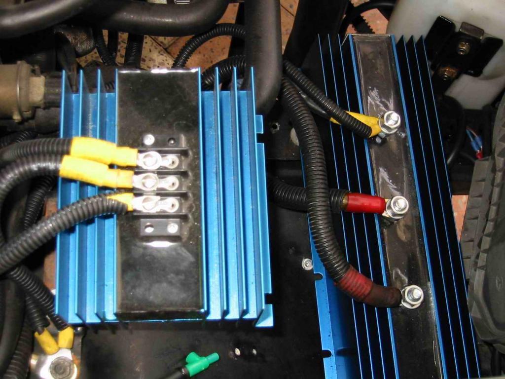

My W124 1st setup 5200 WRMS, 230 amps Ohio High Output Alternator voltage externally regulated with 3 Optimas
High amperage battery isolators

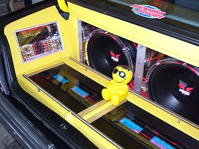

1st Layer Amps
2nd Layer Amps
2nd Setup - SQ & Blasting

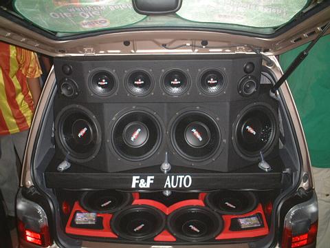

10 subs Kancil
18" Cervin Vega Strokers

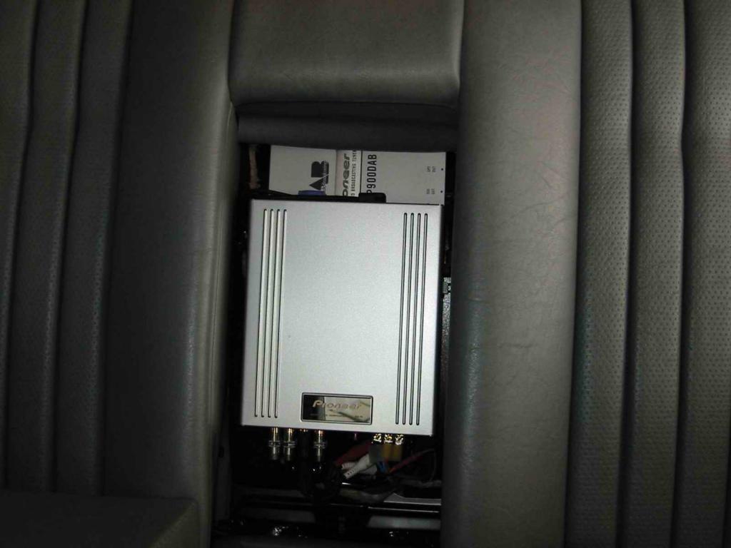

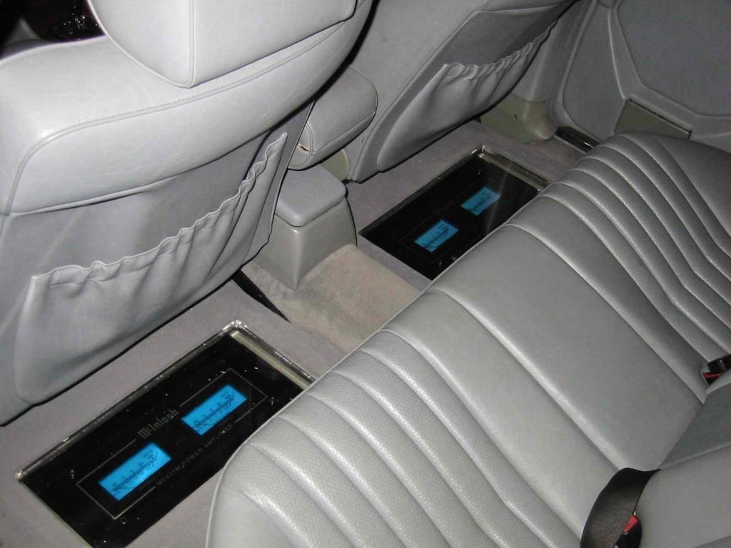

No space for amps......just step on your McIntosh post-84-0-66554500-1419677709_thumb.gif :)
No place for processor and even a DAB - find a hiding place & hide them

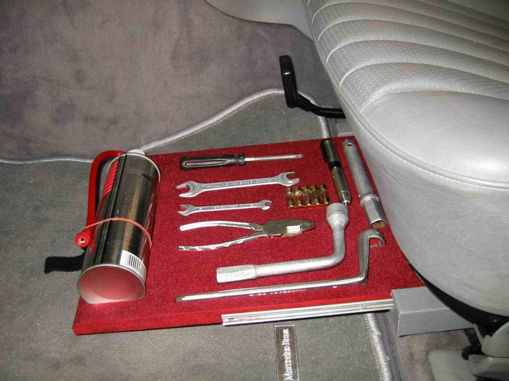

Tools & fuses for your ICE?

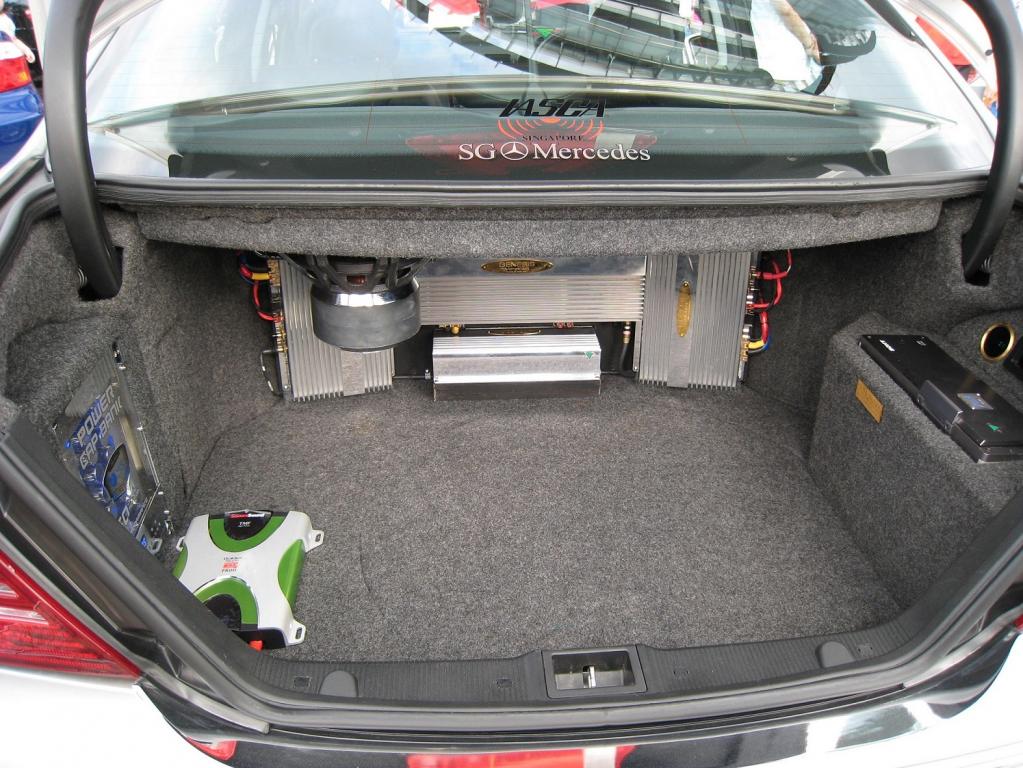

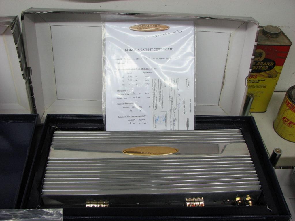

4 Genesis amps, 1 12" IDMax, 1 XES Z50 CD Transport, I Power Bank, Dakota amp meter, volt meter, temp meter, Gold Peak sponsored extra power bank, spare tyre.....still plenty of boot space in the W203 for my wife marketing. :)

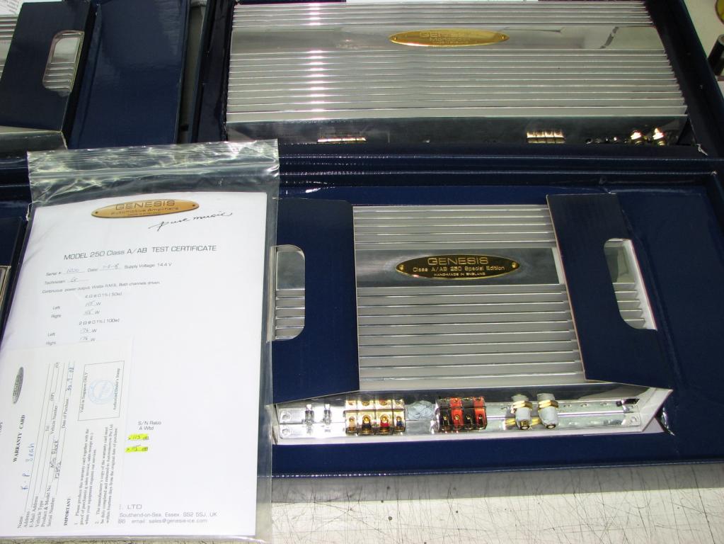

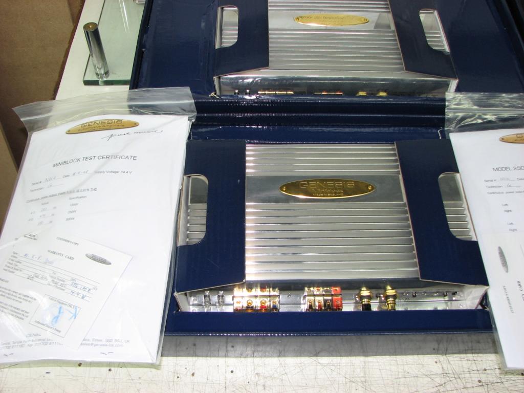

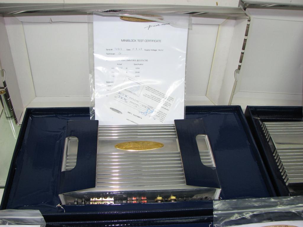

The arsenal of 4 Genesis amps and their birth certs showing the specs and actual tested results.
Should be able to see my name on some of the warranty certificates too
No how siao....zoom in to see the test cert description, specs and actual test results :)
1. Special designed and made for me - Genesis CA250 - Class A/AB dun think you can find another one.
Rated 2 x 50W 4 ohm - actual 2 x 105W 4 ohm and 2 x 176W 2 ohm - I ran them at 2 ohm running 2 pairs i.e 4 pc of XES H50 ribbon tweeters
2. Miniblock 1
Rated at 1 x 125W 4 ohm - Actual tested 1 x 279W 4 ohm - ran 1 pc of 7" MP mid woofer
3. Miniblock 2
Rated at 1 x 125W 4 ohm - Actual tested 1 x 287W 4 ohm - ran another pc of 7" MP mid woofer
4, Monoblock
Rated at 1 x 1000W at 1 ohm - actual tested 1 x 1216W at 1 ohm -
run a free air 12" IDMax Ver 3.0 DVC 2 ohm wired in // @ 1 ohm

The 5200WRMS W124 was running with a 230 ampere Ohio High Output Alternator external voltage regulator.
During blasting voltage is cranked up to 15.5V.
There are other "gadgets" to ensure the 2 RF bd1500.1 amps are run at full output.

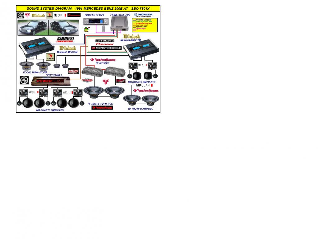

New Generation Cartoon's Vito runs on 2 Ohio High Output Alternator with IIRC 10 Deep Discharge Yellow Optima Batteries.
I ran mine with a 230 amp Ohio High Output Alternator externally regulated i.e I can cranked up my voltage as high as 16V with 4 (1 front + 3 Rear) Yellow Optima Batteries.
We used high amp battery isolater/isolaters to isolate the front battery from the rear.
The juice will enter the 2 x RF Power B1500.1 via 2 x 150 amp Jacobs Accuvolt.
This is ensure no voltage drop to the amps.

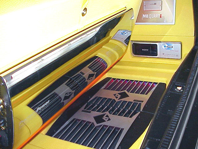

2 RF bd1500.1 = 2 x 1500WRMS @ 2 ohm = 3000WRMS - ran 2 x 15" RF + 2 x 10" RF subs - boot
1 PPI PC21400 = 2 x 700WRMS @ 2 ohm = 1400WRMS - ran 2 sets of MBQuart 218.61Q - boot
2 McIntosh MC431M = 4 x 100WRMS per amp x 2 amps @ 4 ohm = 800WRMS - ran Focal 165W front 2 way + MB Quart 215.61Q rear
Total 5 amps = 5200WRMS
We seen many blasting rides ran out of juices and many dead alternators. :)
We call it power management.
I ran 5 different setups!
This was 1 of it.
