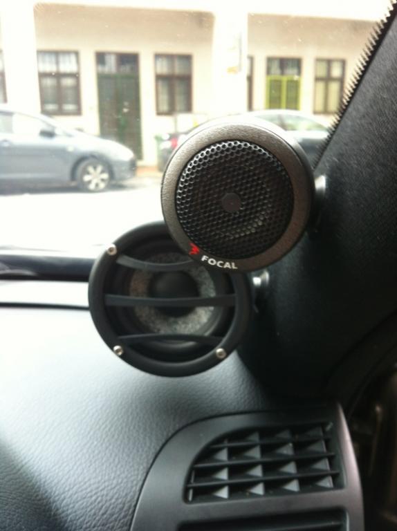

My new speakers
Cool... Which focal model? Can I know your ICE setup? Running on 3-way active? Thanks!
mine is a mix-and-match setup.
Amps : Infinity Kappa Four and db
Sound processor : Alpine PXA-H800
Componet speakers : Focal PS 165
Mids : Focal 3W2 Be
Sub-woofer : db 12"
The current set-up is driven by Infinity Kappa Four and db (cannot recall which model) from previous car.
Infinity is driving tweeters (from Focal PS 165, also from previous setup) and mid range (3W2 BE).
db is driving Focal PS 165 6.5" woofer and db 12" subwoofer (this one came together with the db setup).
After listening to the sound this morning (after last night excitement), realised that there are hissing and "aero" sound, will be going to the installer to get it square away. will provide listener's experience next week.
cheers
cheers

hi g8crasher,
Vincent, the installer, managed to remove the aero and hissing noises. he re-wired, insulated, shifted the sound processor away from the car wiring and some other stuffs. i'm glad those irritating noises are now gone. the next step is to tune it correctly and will do that either tmr or the day after. will update on listener's perspective after listening it for another week. if anyone wants to critic the sound quality, do let me know and we can arrange for it.
cheers
Dear all,
after driving and listening intensely for two days, the noises are back. will be bringing the car to Vincent this saturday for further trouble-shooting. will share the results of the investigation after that.
Dear all,
Vincent added capacitor and one Line out (supposingly will increase the output to the processor) to the setup but the noises are not totally eliminated. still have slight aero noise and occassion radio interference. however, when the system is behaving, can really distingish the various instruments. this may not be a good thing as it is easier to discern CDs recordings that are less than ideal.
Overall experience is slightly above good and also realise our ability to pick up sounds when they are seperated via the three speakers.
