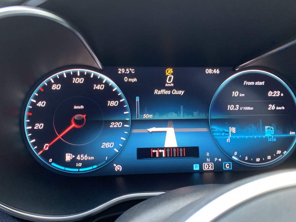

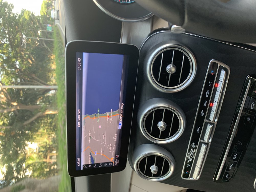

5 hours ago, EHHC said:
I do see the SD Card slot. It can play music files, but when I insert the Map SD Card in it, nothing happens.
Is your the FL C class? The button is not responding to your pressed . You need to buy the lastest 2018/2019 map pilot. Is for wide screen. Once inserted, it upgrade the system and will work perfectly.
Yes, mine is the new FL C class. Do you happen to know the part number for the latest 2018/2019 map? The vendor has sent 2 different map versions to me but they were are not recognized.
