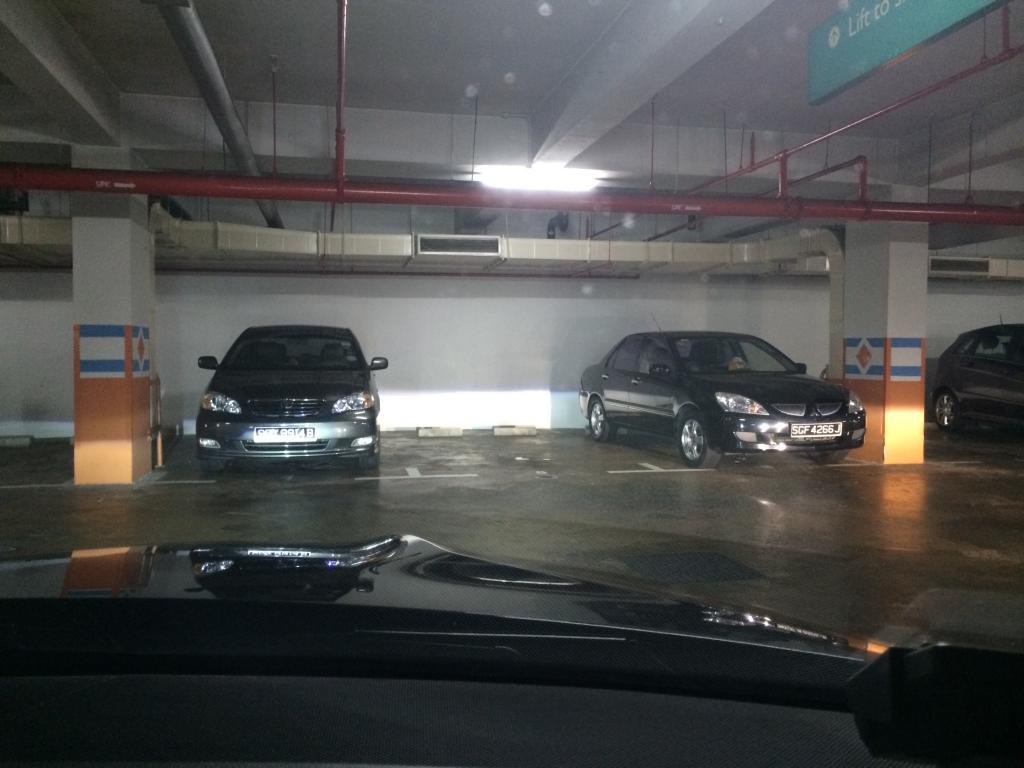

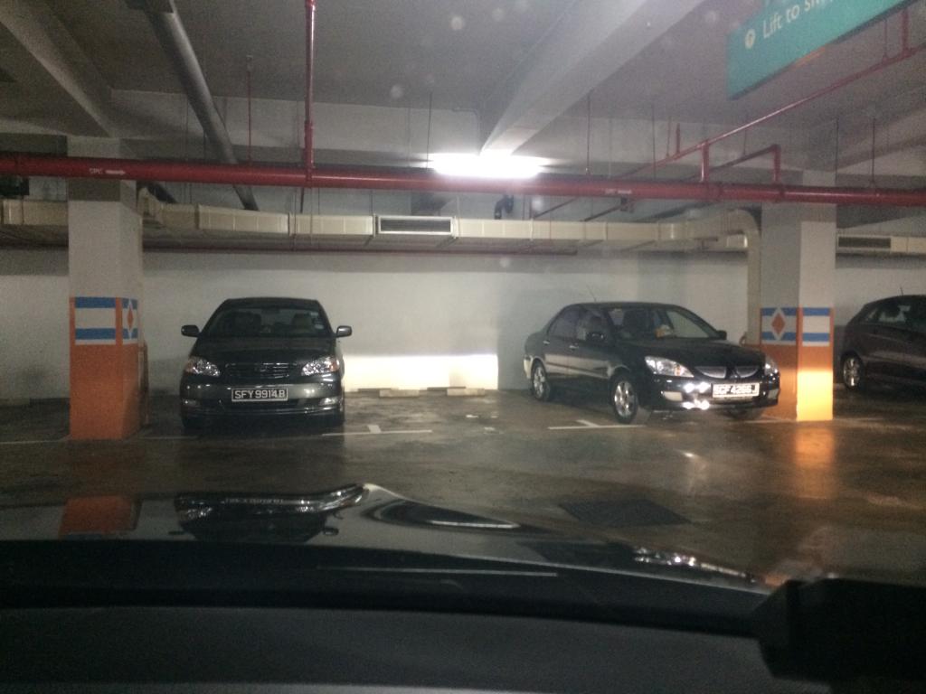

Original ILS on W204 FL
Aftermarket ILS on W204 FL
Do bear in mind, both cars are not parallel straight, this isn't a scientific experiment. No measurements etc. was made. Just happened to have a friend with ILS parked one lot away from me so decided to capture the shot.
All I wanted was for my beams to match up with the original headlights, to light up and allow me to see the road ahead clearly. Height of both beams are almost identical on the wall. Pretty satisfied now, way better compared to the original beam height and penetration. Still gotta go back to get the lights adjusted properly for LHD.
thanks for sharing! seem like aftermarket one produce a 'whiter' beam :)
That's because my bulbs have been upgraded to 6000k bulbs. Originals come with 4300k.
