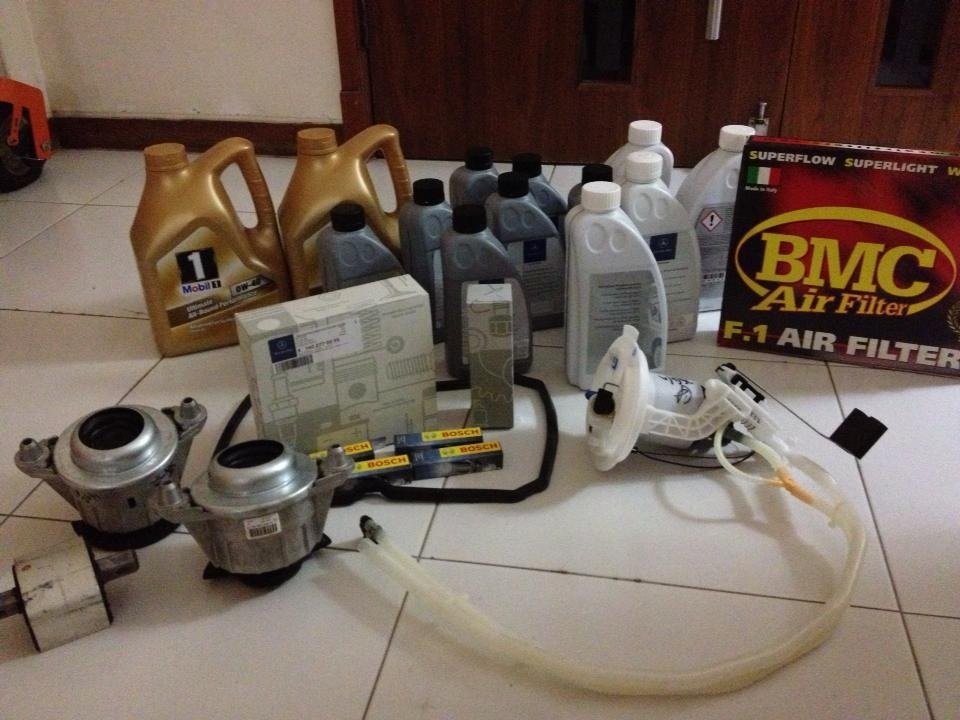

It's very good price bro. I just did my 60k km service B+ where I bought all oils & parts for almost $1k & paid labour of $450. Didn't they advise u to change engine & GB mounts?

For 60k km...as recommended in the C&C menu:
1) Engine oil
2) Brake fluid
3) Coolant
4) Transmission oil, gasket & filter
5) Air filter
6) Aircon filter
7) Fuel filter
8) Spark plugs
IMO, if your car does not use a lot of M'sia petrol, you can skip the fuel filter part. It's rather expensive...$350. Can stretch the change to 100k km.
Engine & GB mounts are optional at this stage...but I seriously recommend that you change them to get the quiet ride like new car.

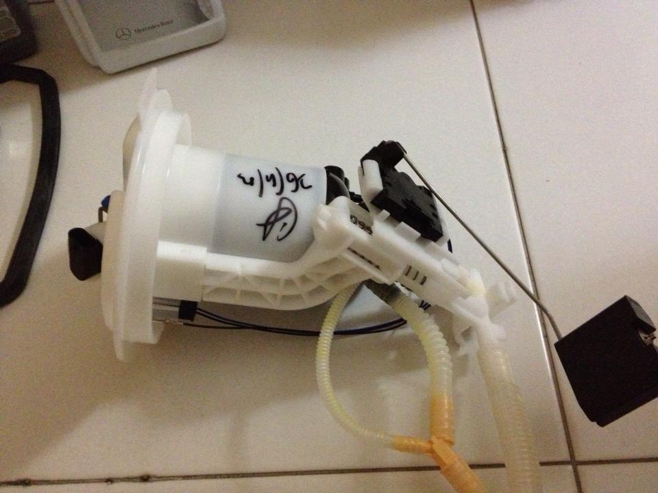

Fuel filter or fuel pump?
Fuel pump cost 350-550 depends on models
fuel filter only 100+
GB mount is gearbox mount

I plan to purchase own parts and change the Engine & GB mounts outside soon. Please advise many Engines mounts to purchase for C Class W204. From the picture you posted, i guess Two Engine Mounts and One Gear Box Mount?   How much it cost approximately for the mountings? Thanks
Jtang,
U r right about 2 engine mounts & 1 GB mount. Price wise....I'll need to chk the receipt when I return from my vacation next week. Alternatively, give Goldenlink a call to chk on price.
