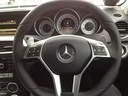

Hi Everyone,
Just like to share a mod which I have just done. I have installed a C63 steering wheel on my 1.6 Kom which comes with 5 speed. This was done without the "wire" but by programming. This is only possible on the 7 speeds CGI but now the 5 speeds Kom can also do it.
After this mod, there will be an extra M (manual mode) other than E and S. M mode will show all gears in 1,2,3,4,5
I got the C63 ($1600)from Dr Hannson and installation ($400) done by Ah Boon from AutoSprintz. Installation can be done in less than 3 hours.
5 speed = D1, D2, D3, D4 + reverse gear. The up and down shifters will show D1-D2-D3-D4-D if you cycle through the gears.
looking for an angry fix... "

I correct you. When engaged to M, it will show 1,2,3,4 and upto 5. Not the D1 to D4.

During the programming stage, Ah Boon need to hook up to the Germany programmer. Progrmaming not done by Ah Boon. So it will be better to go in the afternoon when its in the morning in Germany.
No Stripping of dash board. The only physical work is changing the steering wheel.
