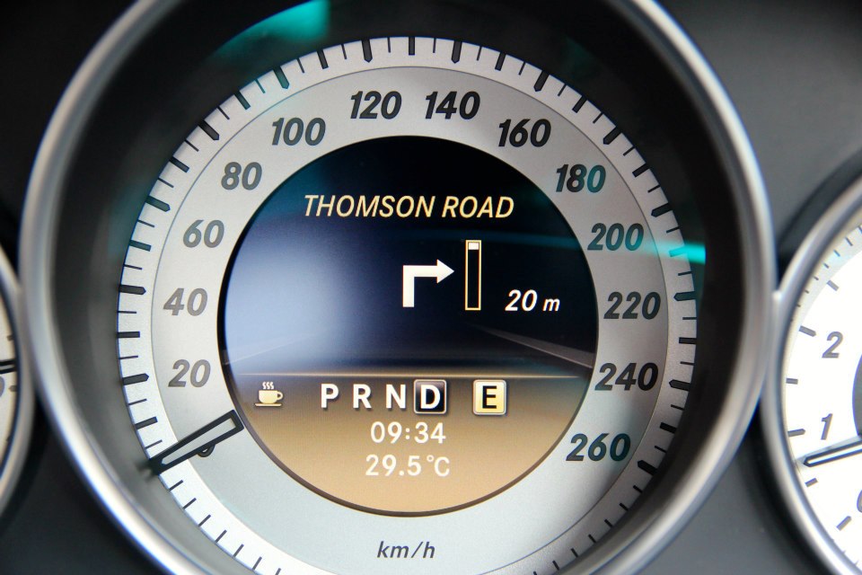

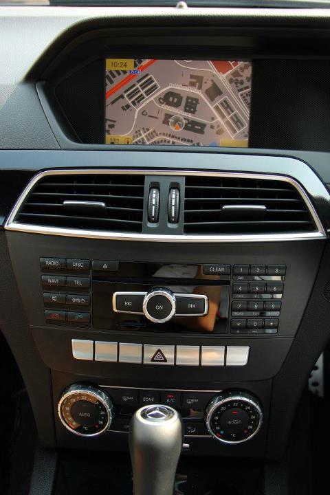

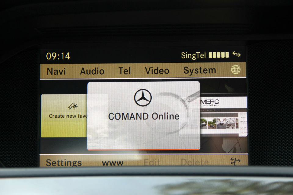

Everything finally works, had the latest 2012 maps installed and I'm able to connect and surf through the Comand Online system. Super thumbs up to Ricky for the hard work after so many months.
Comand Online NTG4.5 retrofit, trialled and tested, fully functional.

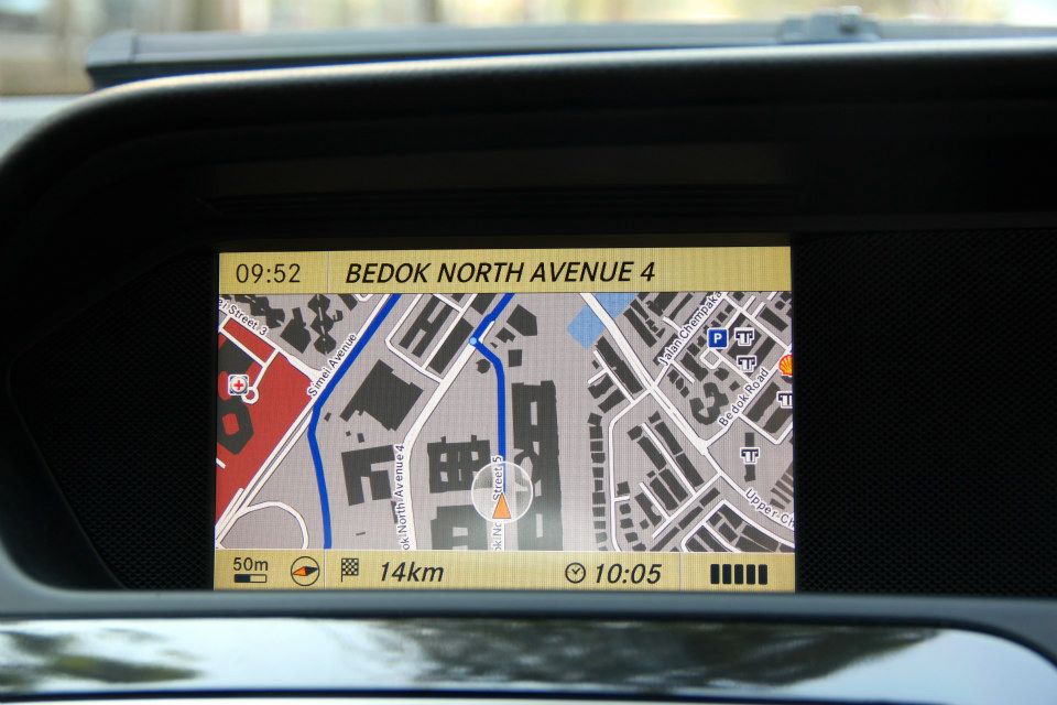

Navi with latest SEA maps
Comand Online

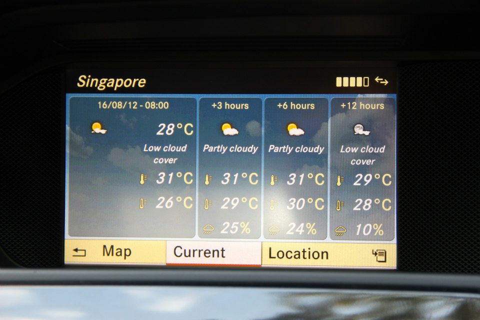

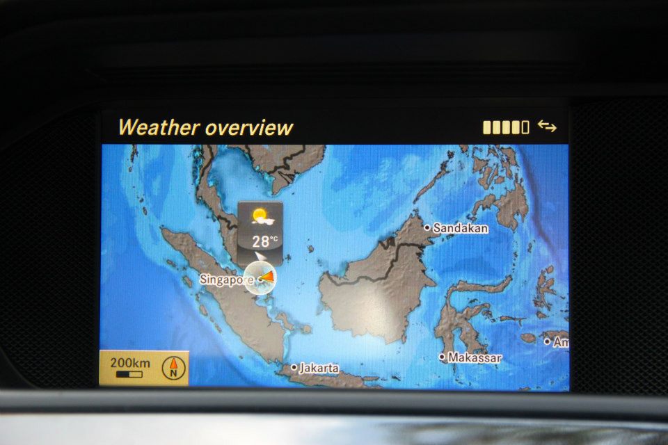

Weather App

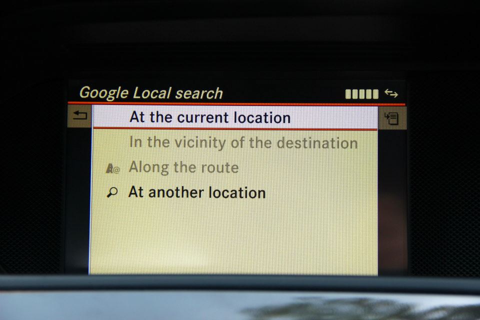

Google Local Search

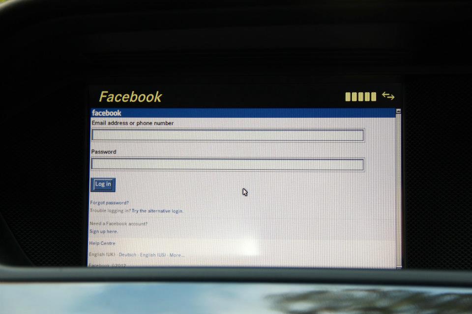

Facebook
For those of you who've been waiting for this, MTL!
Understand that your system is now fully operational with the installation of the 2012 map?
With the 2011 map, the NAVI was not operational?
Understand that the Internet access is based on the DUN concept n as long as your mobile has DUN and allows sharing, it should work less it is the iPhone.

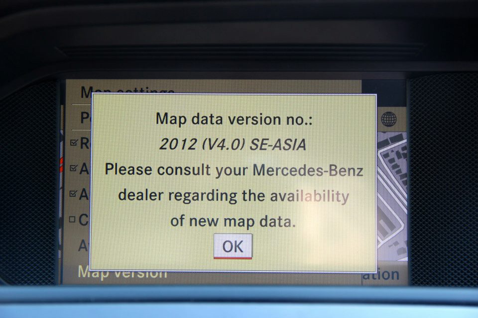

Yes, the 2012 (V4.0) SE-Asia is the latest map for NTG4.5.
Cheers, Ricky
Hi Bro Mark/Ricky,
Is this confirm NTG 4.5 map, I am bit confused since my car alredy delivered with this map when I got the car in Dec 2011:
My map version:
IMG-20120105-00032 by Thedi David, on Flickr
I always thought my map is obselete.

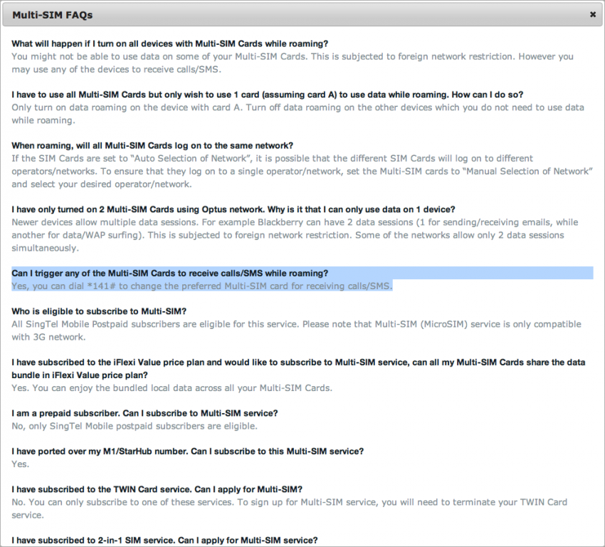

For SingTel users, you're able to change your master sim card by dialling *141# using the SIM card which you want to activate as master. I assume StarHub & m1 would also allow you to do so.
http://info.singtel..../post-paid-plan

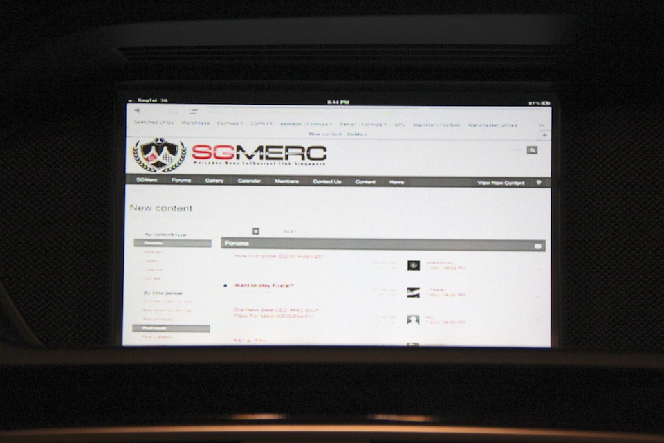

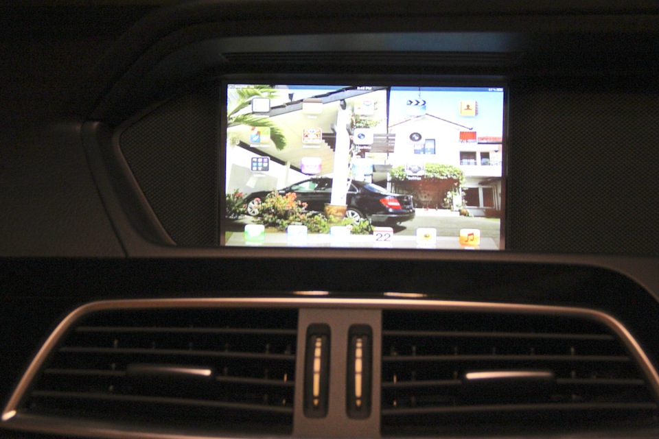

Latest Addition: iPhone & iPad Mirroring
Showing the Home Screen
Safari

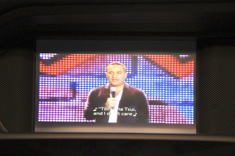

Video

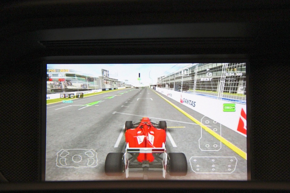

Game
I added on the iPhone/iPad module to the system.
Is this the AD2D (or somthing like that) which allows the video display from media (e.g BT phone) to be display on another screen.
Does this mean that you can control the iPad/iPhone screens from your command screen? If possible with a BB wifi you don't need DUN.
No, this is just iPhone mirroring. What you see on your iPhone will be shown on the screen. It's aftermarket. The device is connected by a new cable and what it does is simply feed the LCD screen, (be it Comand or Audio 20) with video out from the iPhone. Controling still needs to be done on the device itself.
As stated many times, there is no way still as of now to use your iPhone's connectivity to connect to Comand Online.
