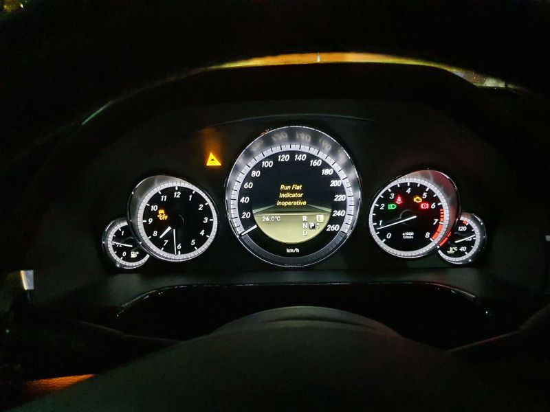

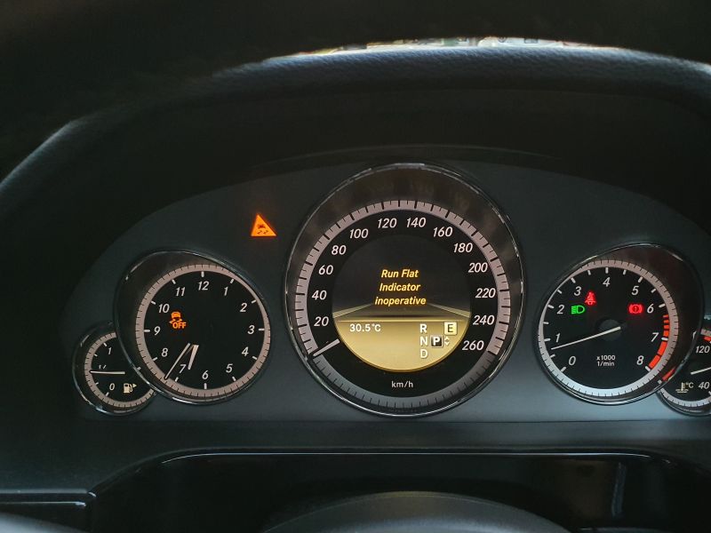

Any one can share if you've encountered similar problem? I bought the car (2011 E250 7G W212) when it was 7 years and been driving it with no issues for the past 3 years. Just last week the car suddenly stalled while on the road and died off,step on acceleration no power, steering became stiff,  displays the esp off and run flat indicator and would stall again less than a minute after restart. I had to tow it to my workshop and workshop said was ecu problems. Fast forward, after it's fixed, I got the car, no issue at mechanic place, drove back and when reaching back the car stalled again with the same issue showing run flat indicator and esp off. Now its back in the workshop to fix the ecu again.
Some pointers I notice were:
1) Low idling rpm of around 600
2) After repair Eng stalls only at idle
3) Happened twice after ecu fix, while driving and there was a quick jerk, sudden drop in rpm noticed (from 2000 to around 1000) but car didnt stall
4) ESP off warning shows after car stalls
5) Runflat indicator shows after car stalls
6) Car stalls around 25 secs after stopping at traffic light.
Car was recently serviced and had all 4 brake disc rotor, brake pad and brake sensor changed. Low mileage under 80k, Everything stock condition.
Please share/advice if you guys have encountered similar! Thanks!
