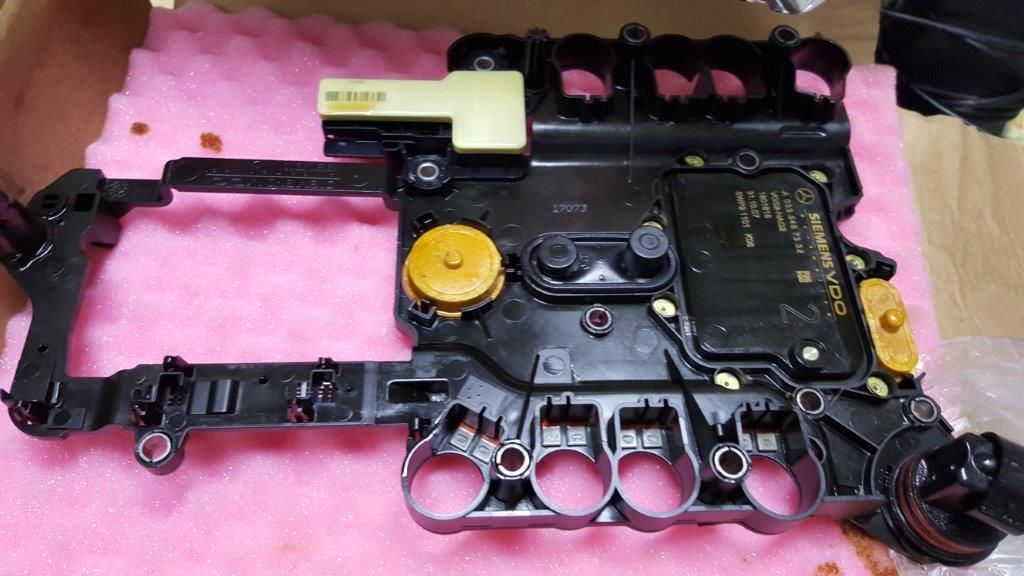

http://i874.photobucket.com/albums/ab308/hyundai8818/GB%20PLATE.jpg
Does the parts they change looks something like the attached ?

Yes bro AHYEO,
looks exactly like this pic. I also don't understand why it is plastic material?
yalor, put plastic inside a bloody hot GB is just a matter of time before it fail !
btw, my mechanic says that "plastic" should last 200K km, dunno true or not leh

Unfortunately, the input/output speed sensors on the conductor board are the weak links in the conductor board. At least there are reliable repair solutions available nowadays - imagine in the not so distant past where it was mainly a 1 to 1 gearbox exchange policy much like the current Porsche PDK gearbox made by ZF.
I think MB do not manufacture these sensor parts themselves and repair method(s) is/are already commercialize and should be widely available by now for technology that is decade old.
Found this link from Wikipedia (German language website) which offer the corresponding solution for 722.9 repair parts (error codes P0717 / P0718 / P02767 / P02768):
https://ecu.de/mercedes/getriebesteuerger%C3%A4t/vgs---nag2-(7g-tronic)-5150/
