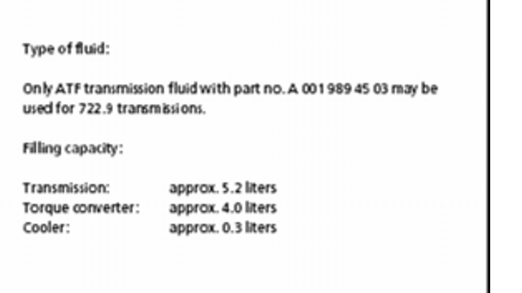

Bro Ah Yeo,
Share contact and address leh...thanks.
2006 W211 MERCEDES E200NGT
Transmission 5.2ltr
Torque Coverter 4.0ltr
Cooler 0.3ltr
Wah Bro CH_OldMerc
thanks for doing all the homework !
So the guy at Gallop is correct, we will need 10 bottles of the ATF for E230
