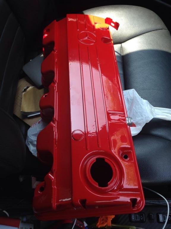

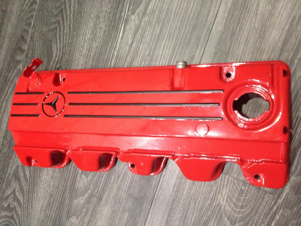

Try replacing the seal first, it's only a few bucks, and make sure the bolts are not over-tightened, or else they are more prone to leak. 8-10nm is the spec iirc. also, for the 8v covers a lot of mechanics like to put a bead of high-temp RTV silicone to ensure the seal is complete. The problem with the covers is that they are made of a composite, which can warp over time. If you do get used, try to lay it on a large flat slab to make sure it is not warped.
