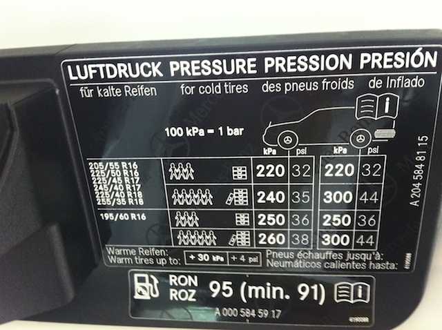

Please check the recommended PSI at the fuel tank cover there....
Stock, originals or replica rims doesn't affect the tyre pressure. So long the tyres are one of the recommended sizes.
Bro, plse confirm your picture is from a W204, n the YOM. I'm just checking it against mine. Tks in advance
