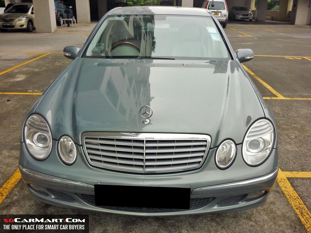

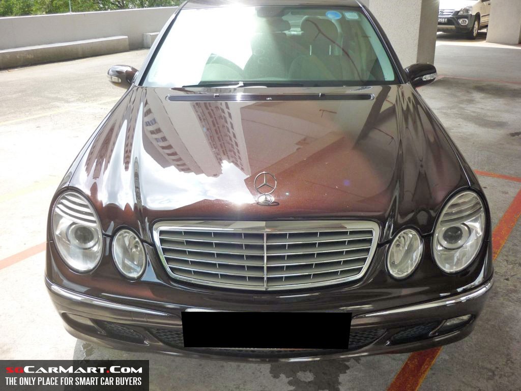

I changed mine.

HI, I am trying to change my Pre Fl w211 headlamps to new FL (with eyelids) ones. May I ask did you do any changes in the socket at the back of the headlamps? Or they are 100% plug & play?
Hope to hear from you soon. Thanks.

Thanks iMac.  Very good, it is a plug and play unit. did you convert with this depo headlamps ever?
so i need to purchase xenon CANBUS conversion kit to work together with the headlamp? any recommendation for xenon conversion kit?
There are a few company that produce these aftermarket headlight.
I was told Taiwan's DEPO Auto (帝寶) is a better brand.
It is simple plug and play without any need to modify the existing cable.
I use back the same original H7 light bulb...unable to recommend any xenon stuff to you.
