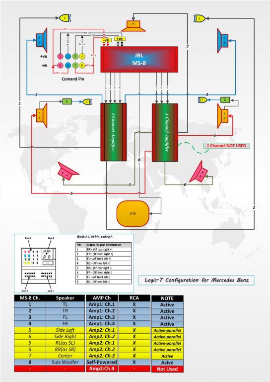

This is my setup. I had discussions with many audio Sifu's around the world...on many forums...This is for a Comand NTG on a C class
May be of use for audio enthusiasts
