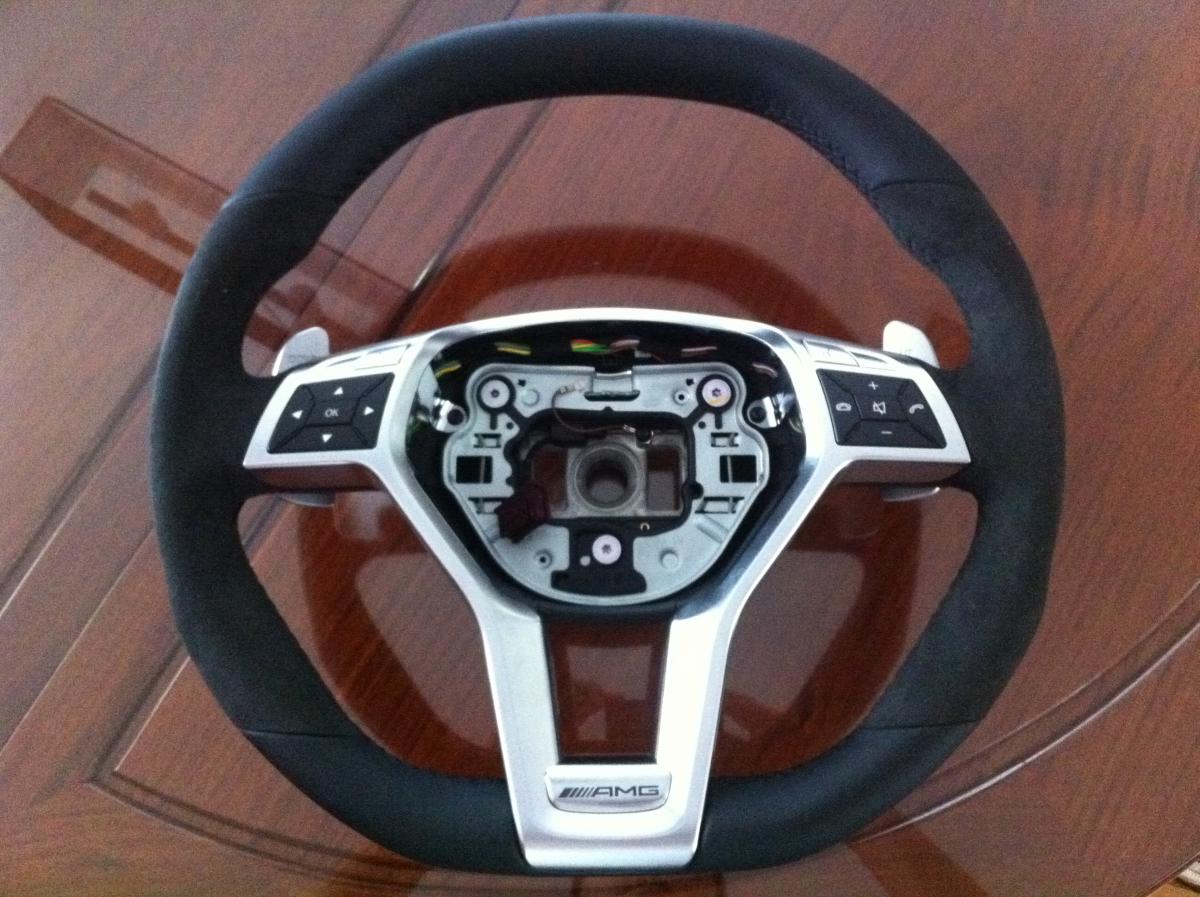

Pic of the Alcantara Wheel !
This is a velvet like material right? Don't think it'll be suitable for people with sweaty palms like me!
Yeap, it's Alcantara - very nice for me cos I got dry hands. It's a bitch when wet or damp >_<
looking for an angry fix... "
Yup. That's why I went for the leather one. But I do like the AMG at the bottom, the leather one says Airbag.
Ah I didn't know there was a difference other than the leather trim!
Yup. Check out my photo.
