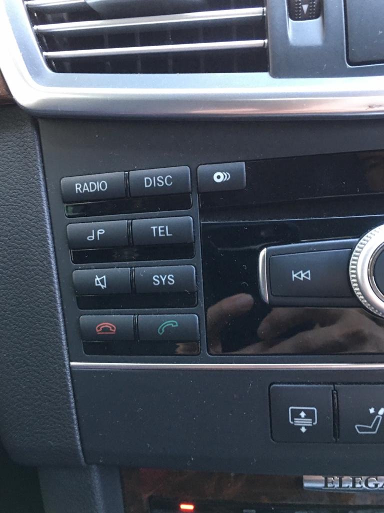

  • My car has no "Speed Warning" nor integrated GPS (first pic below - No "NAVI" button).

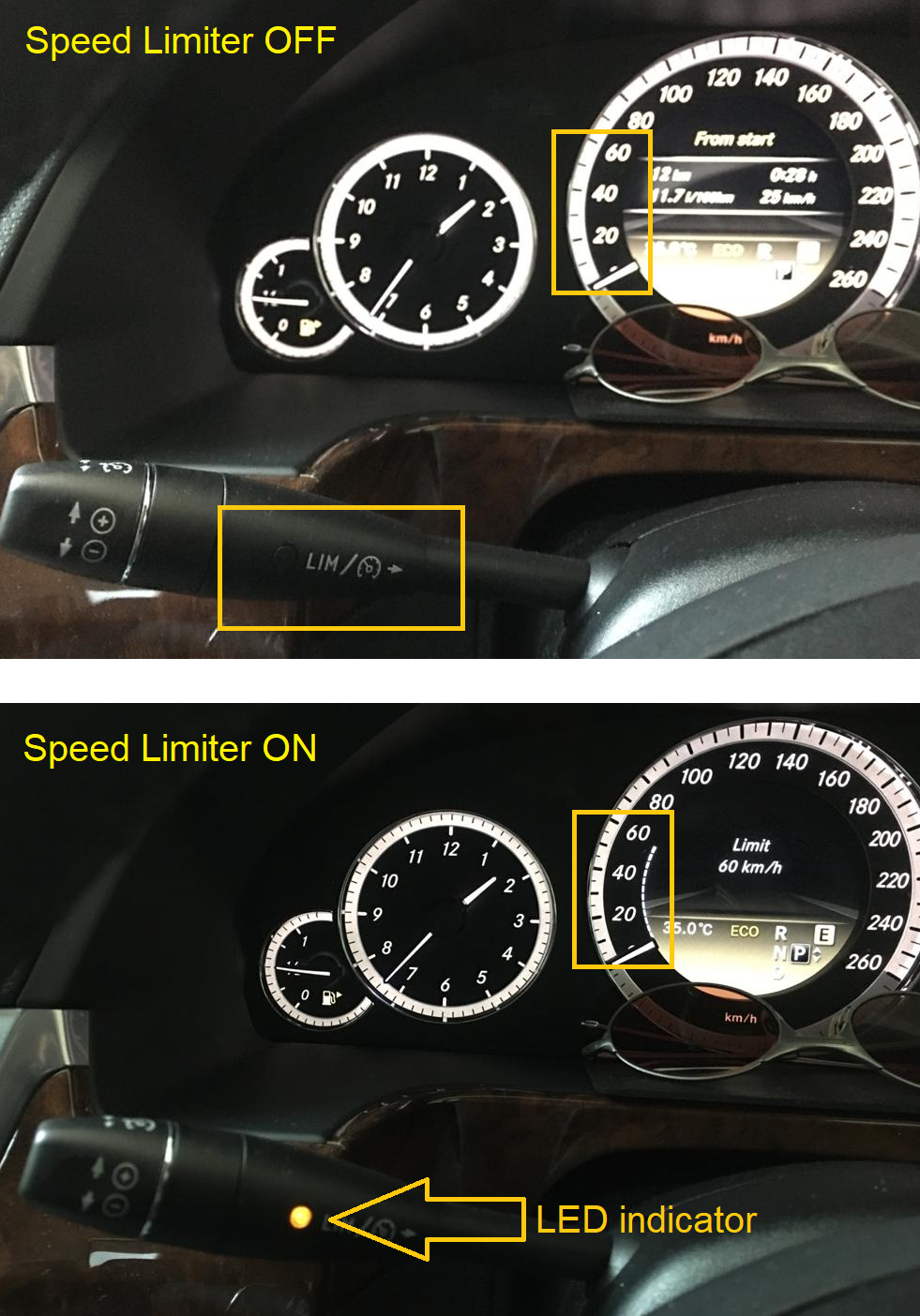

  • So closest function is the Speed Limiter, which I had set to OFF. (second pic below, showing speed limiter ON/OFF)
  • I turned this Speed Limiter ON and OFF again, just to make sure it is OFF.
  • But the "Drive Carefully" still comes on - video with sound attached.
  • In the video, my multimedia screen is Off, speed limiter is Off...
and so the Mystery still still remains unsolved... 😟
The LED indicator is for the speed limiter and is usually turned off.
The stalk is for both cruise control & speed limiter.

it is an aftermarket GPS system that is integrated into the MB system.
The way to activate it?
Hold down the “Back” button for about 3 seconds, and miraculously the Galactio V8 GPS screen appears on the centre screen!! MAGIC!!
From there, just play with settings to turn off warnings.
I’m the 2nd owner of this car and never knew there was this nifty little function built in.

From your description to activate it, it looks like the previous owner installed an after market multi media box which includes the Galactio GPS feature.
Your original input cable to the stock HU is connected to the input of multi media box and the multimedia box includes another cable connecting it's output to input of your stock HU. Likely the multi media box is hidden somewhere behind your stock HU.
