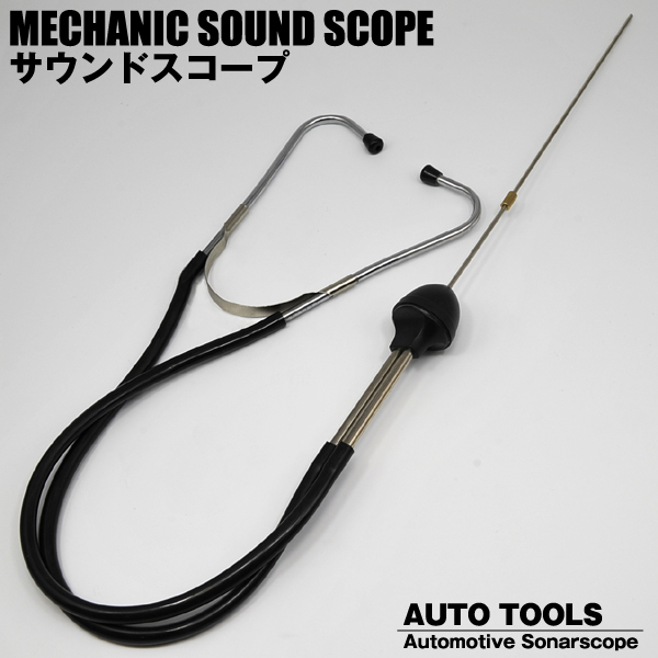

Anyone know which workshop got those "mechanical sound scope" which can accurately detect the location of the sound?
