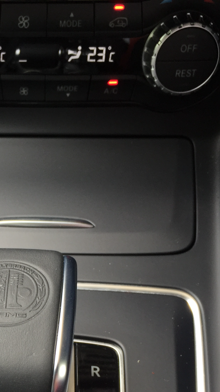

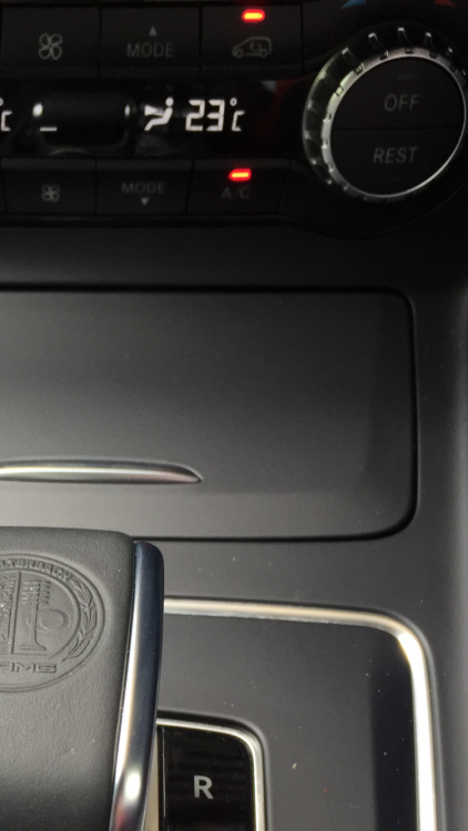

Dear experts,
Just taken over E230 2008 noticed that the each time after driving and re enter the car after 10-30min.
There is kind of heat trapped in the car. All my previous ride dont have this problem.
Feel hot inside...like heat coming from somewhere.
Is that normal?
First thing, it is a safety feature for merc that it will auto switch to take outside fresh-air after 20-30min of driving.
When you feel hot air coming in, take a look at the panal....is the internal-air-circulation light goes off ? if it is, press it to switch back to internal circulation.
Next, check your 4 Zone Thermotronic Control , passenger side and driver side have their own temperature setting.
Is all the Zone same setting ? Sometime, one of the zone-valve kana stuck...that zone will blow hot air...
2006 W211 MERCEDES E200NGT
This is the Climate control that's working in winter condition when engine is off.....it blows hot air from the engine heat for about 10-15min at very low fan speed.
Switch off the REST button....its in the manual.
Not depressed, in fact dont have this feature.
Any advice. thanks
