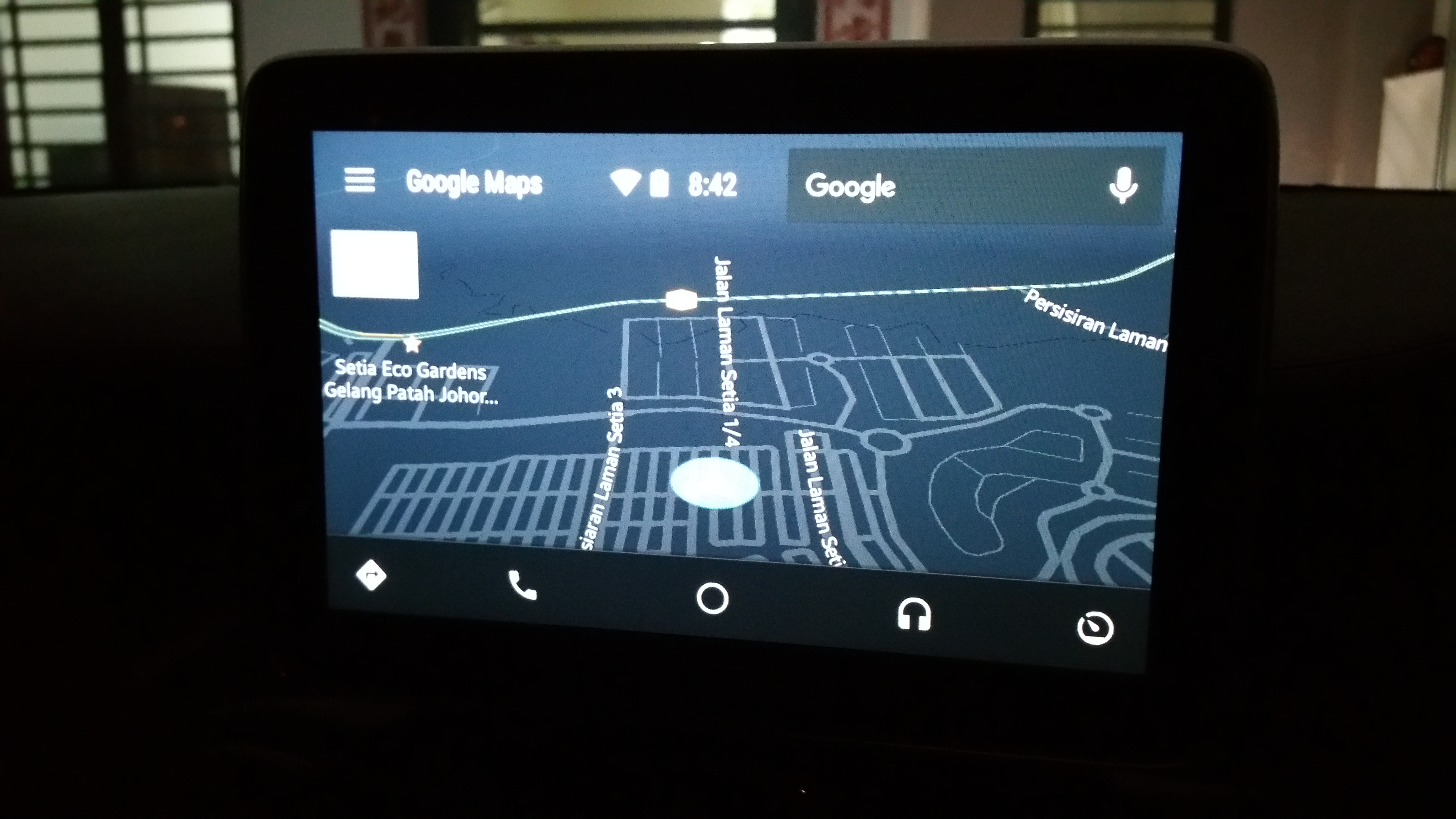

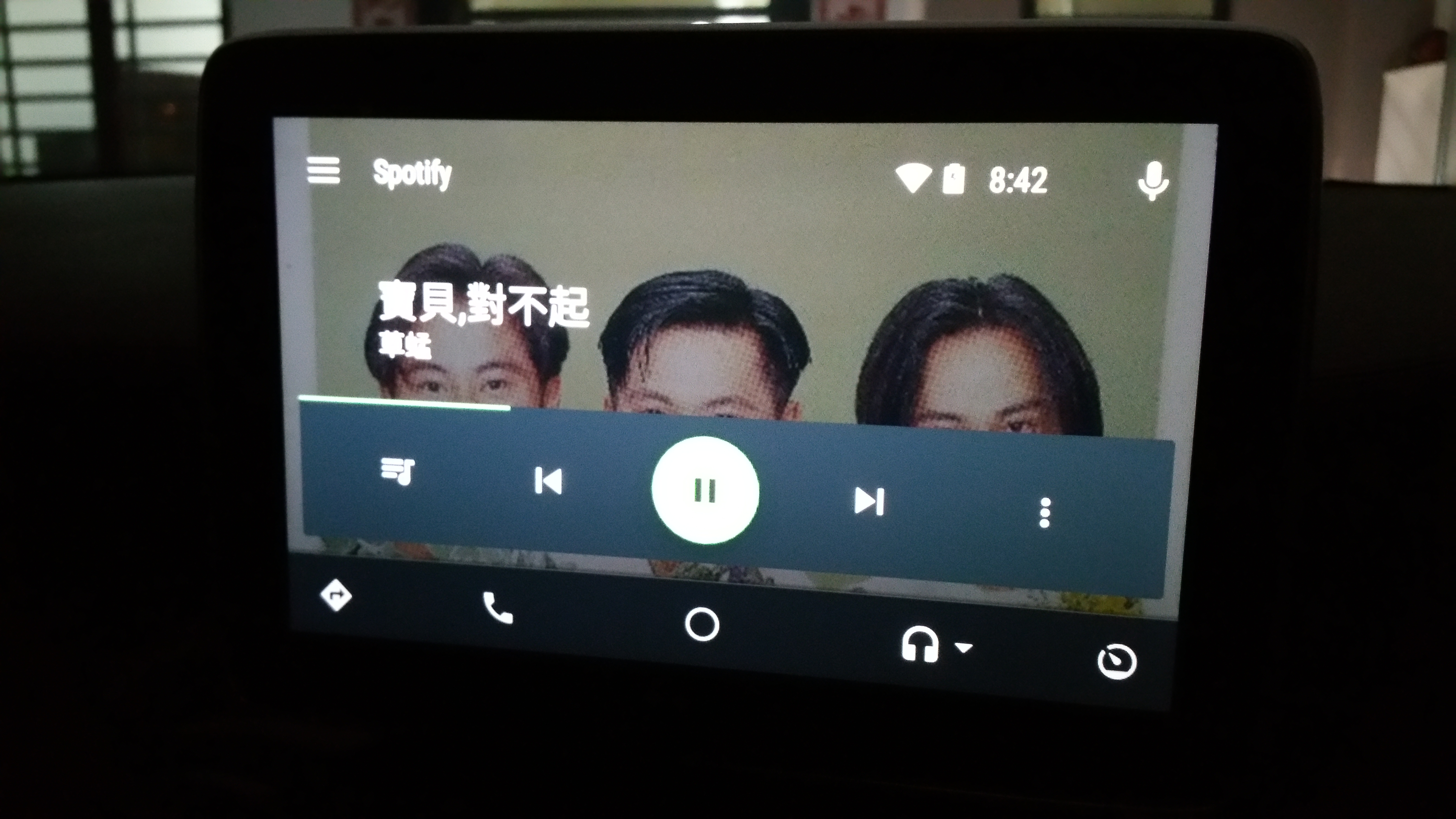

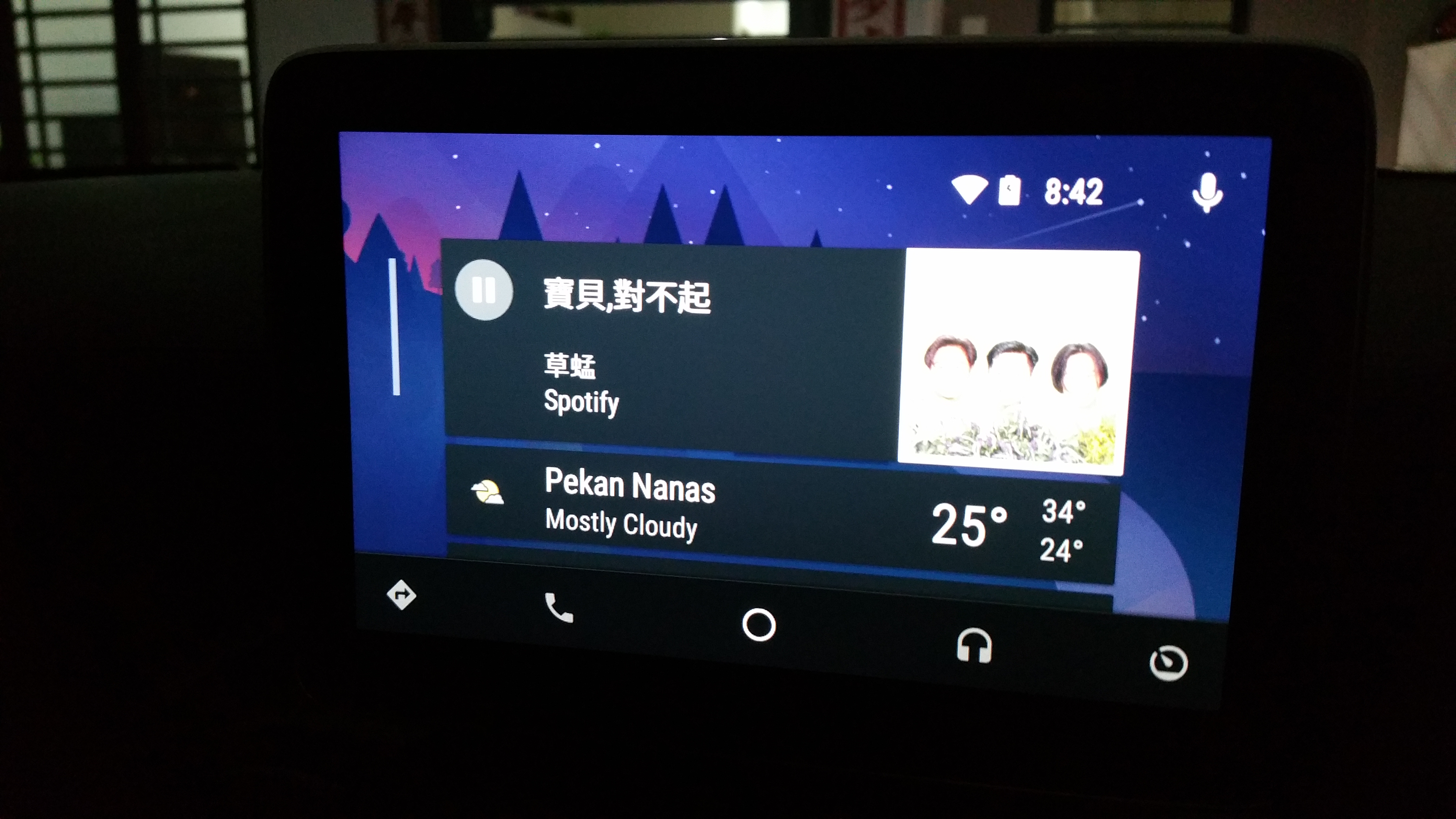

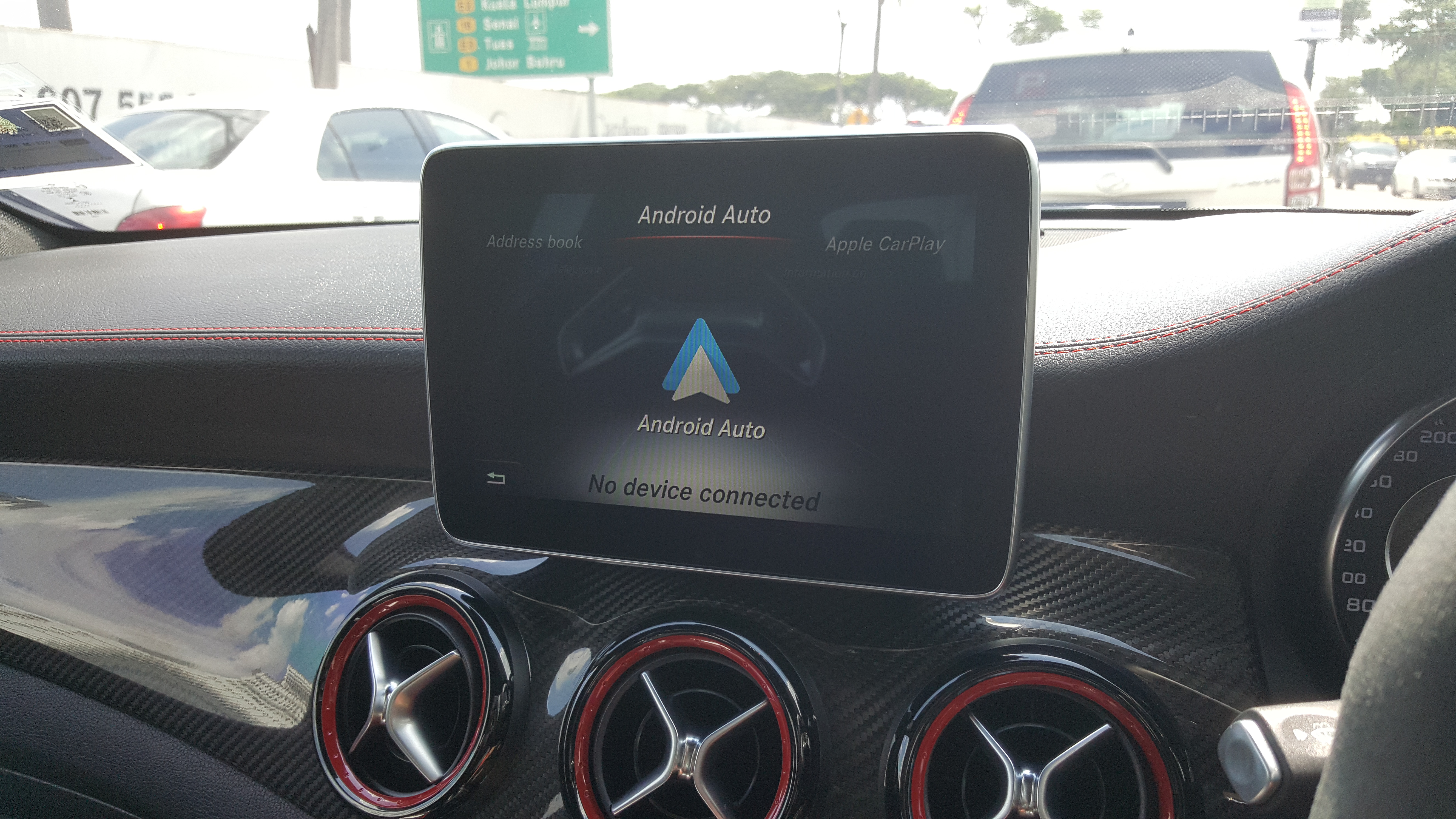

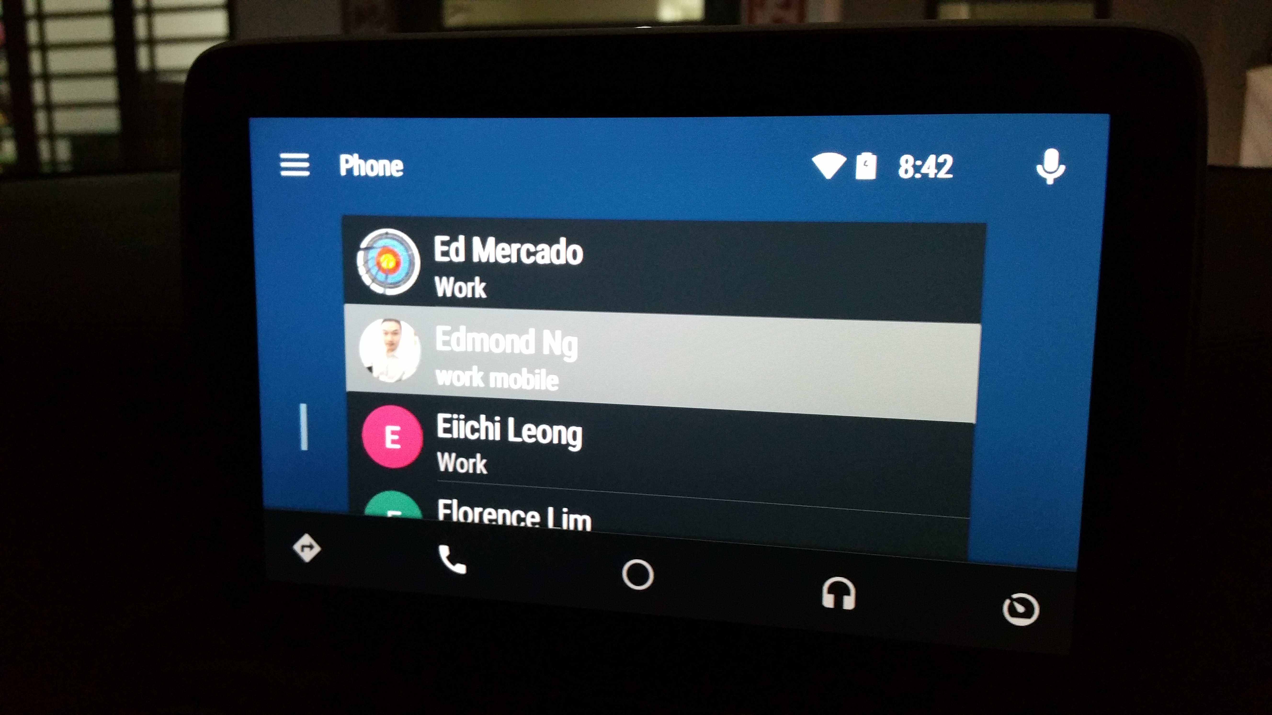

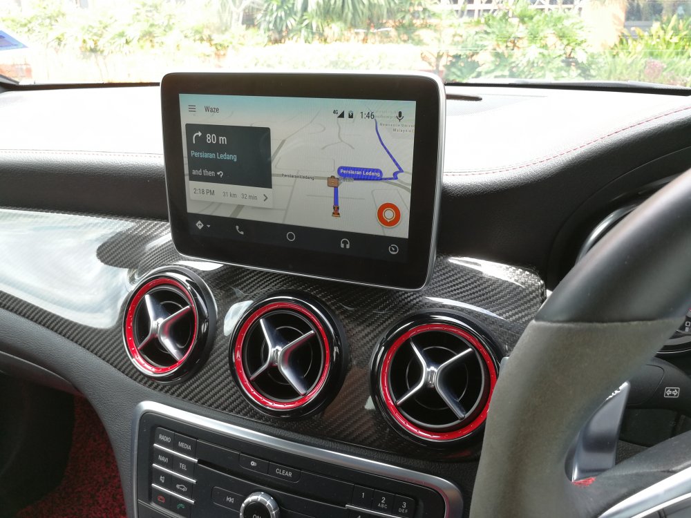

Hi Guys,
Finally got the Smartphone Integration Package retrofitted onto the car. Attached some picture of it.
My current phone is running Android so naturally I will be using Android Auto (AA). I did try out Apple CarPlay for a while using my technician's iPhone but didn't have much time playing around it.
I use Google Map, Spotify and Whatsapp mainly with AA.
Google Map: If you have used Google Map on your phone before, it more or less works exactly like it was on the phone. I use voice input mainly to enter destination. For more complex destination, I will enter the address on PC or phone first, then it will be recorded down as recent searches in AA. Last choice of input is to use the wheel knob to enter address, which could be tedious if you are entering street name etc.
P.S. I prefer Waze over Google Map, am just waiting for Waze to be launched on AA. Will switch over to Waze when it launches.
Spotify: Work exactly like on the phone itself. Perfect except for a few things. Changing track require more steps than without AA (i.e. using BT with NTG5). You need to navigate the cursor to the [Next Track] icon and depress to change track as compared to just turning the wheel knob when using BT with NTG5. I have to change my habit to use voice input to change track.
Whatsapp: I use voice input to send message out to friends, message will be read to you when you have receive one. However incoming group message won't be notify, nor can you send out a message to a group chat. Incoming voice message will not work as well, you won't be able to hear the recorded message, nor can you send a voice message.
Pretty satisfy with AA.
