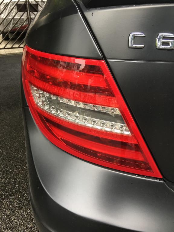

Then This is my taillamp
I check out with C&C they told me my is original..
I book appointment with them to see if this can be rectified by them..Hopefully can
My headlamp also same.. all wiring fry and can see the bare wire liao
Forgive my ignorance but the photo you posted doesn't look like the original FL tail lights. And to my knowledge, MB didn't come out with a LED tail light in between the launch of the FL model and the preFL.

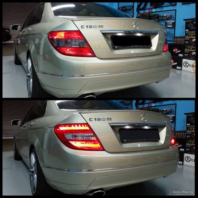

Bro, this time you've got your facts completely wrong.
W204 C-Class has been in the market from 2008 till 2014. During that period, the car was facelifted (FL) or if you prefer, refreshed once in 2011. Therefore W204 pre-FL stands for vehicles manufactured from 2008 to 2011, W204 FL is from 2011 to 2014.
W205 C-Class is a completely new model launched in 2015. The FL model for W205 will probably be launched in a year or so.
Back to the W204.
Pre-FL models come with halogen tail lights (top picture), where else the FL model comes with LED turn signal lights (bottom photo, or the photo in my earlier post):
Note for the original FL design, the LED turn signals run the full length of the tail light unit.

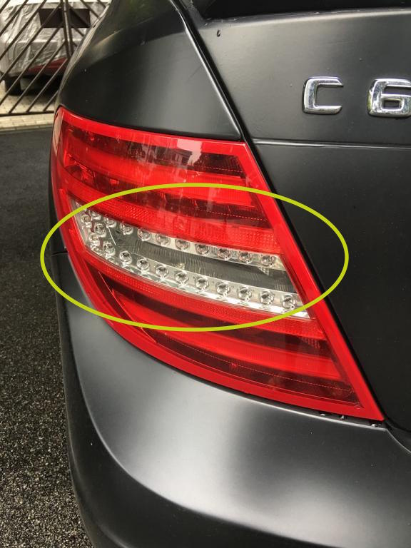

I believe yours isn't original as the LED turn signal lights don't run the full length of the tail light unit, similar to many aftermarket designs. I made this conclusion based on the fact that to my understanding, MB only released two types of tail light for the entire W204 range which is the two designs above.
To my understanding, it is possible to install the "newer" FL tail light (original) onto the pre-fl W204 albeit with some programming. I'm unsure how the aftermarket tail lights can be installed. My advice would be to check with the workshop that will be doing the installation especially on compitability, don't just trust what the website says.
