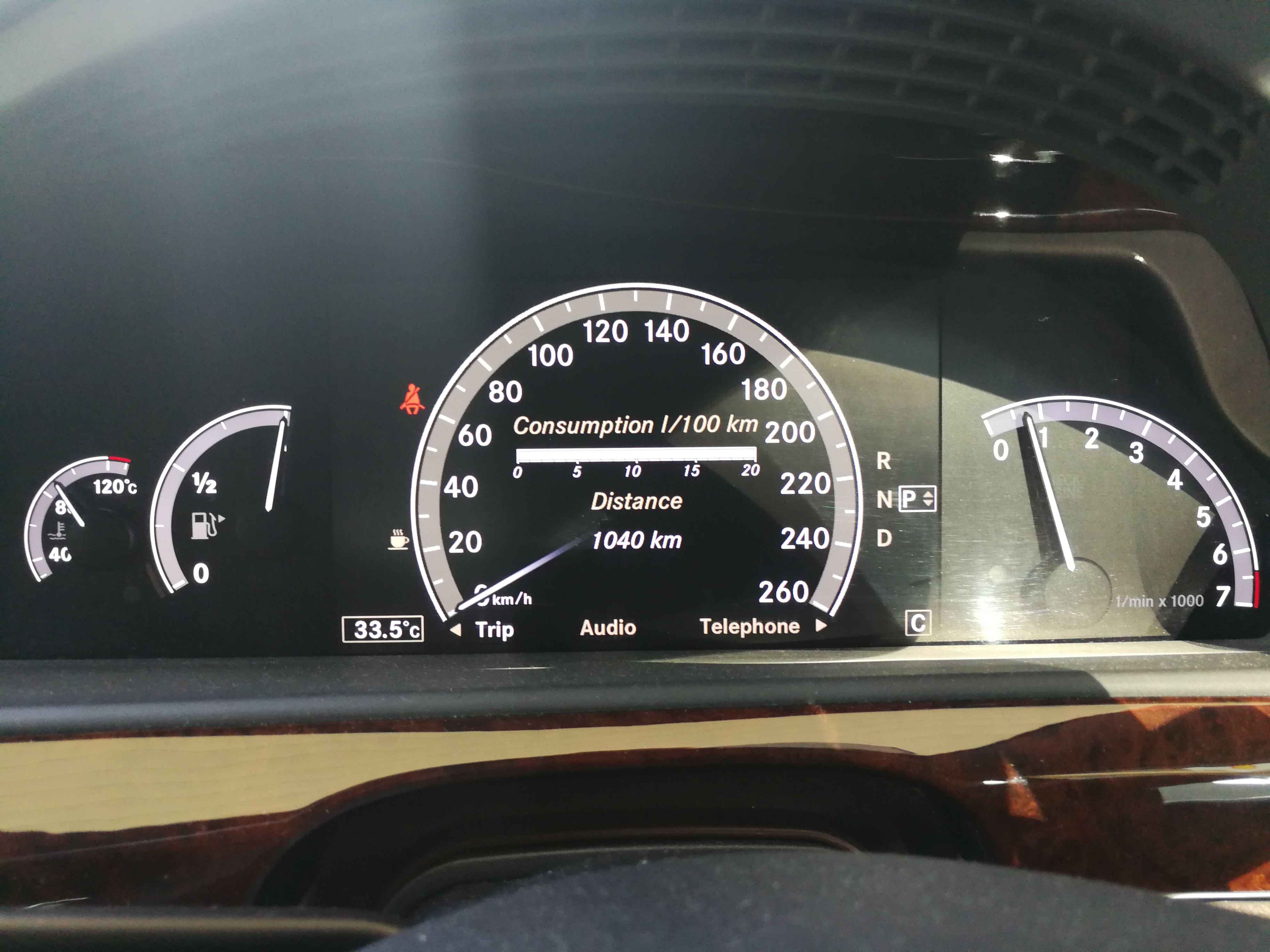

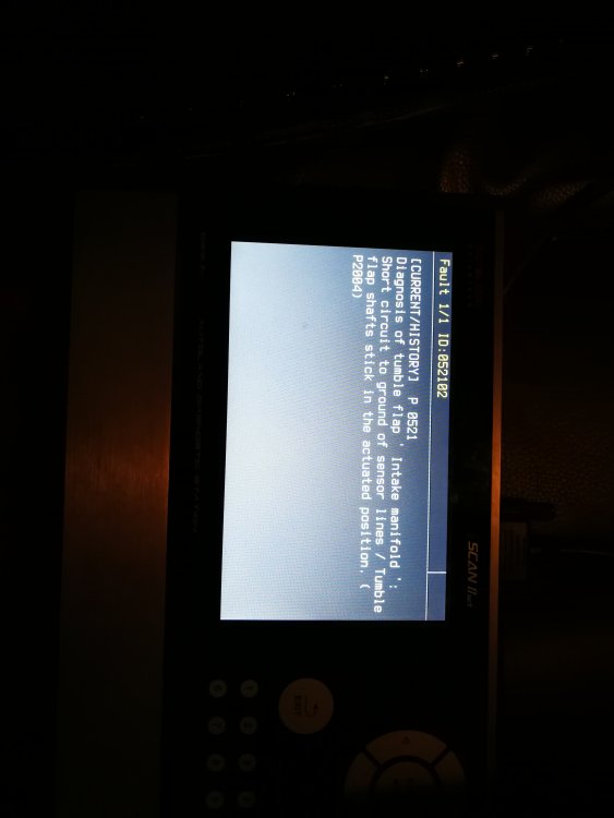

I just replaced my intake manifold with an oem unit. I will have the say the car is noticeably more powerful from standstill and at lower rpm (which is most of the time the rpm which I drive at)
Because of the higher power I feel that i give less throttle input when requiring to accelerate or climb uphill. I'm looking at about 10L/100km consumption now. Down from 11.5-12L/100km
I think it's worth it. Almost like a power upgrade.
Following up on this after a full tank of fuel.
Maybe I'm getting more heavy footed, the traffic that I go through these days are quite usual
There seems to be not such a large improvement after replacing the manifold.
Before replacing I'm getting 8.6km/l (11.6l/100km)
After replacing and running a full tank of fuel the recorded fuel economy is 9.1km/l  (11.0l/100km)
Power still noticably better between 1.5-2k rpm. Just to update so that those who consider to replace can do proper math.

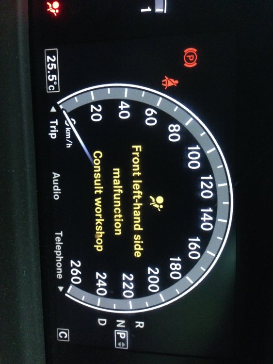

bro wings17, believed its the front airmatic kaput liao...do visit one of the recommended WS (Zen Auto-Ah hui / Chip Soon Auto - Daniel). But ask for a thorough diagnostic first.
One side front airmatic would probably set you back by 500-800$...
End up is just the seat occupancy sensor giving issue.
