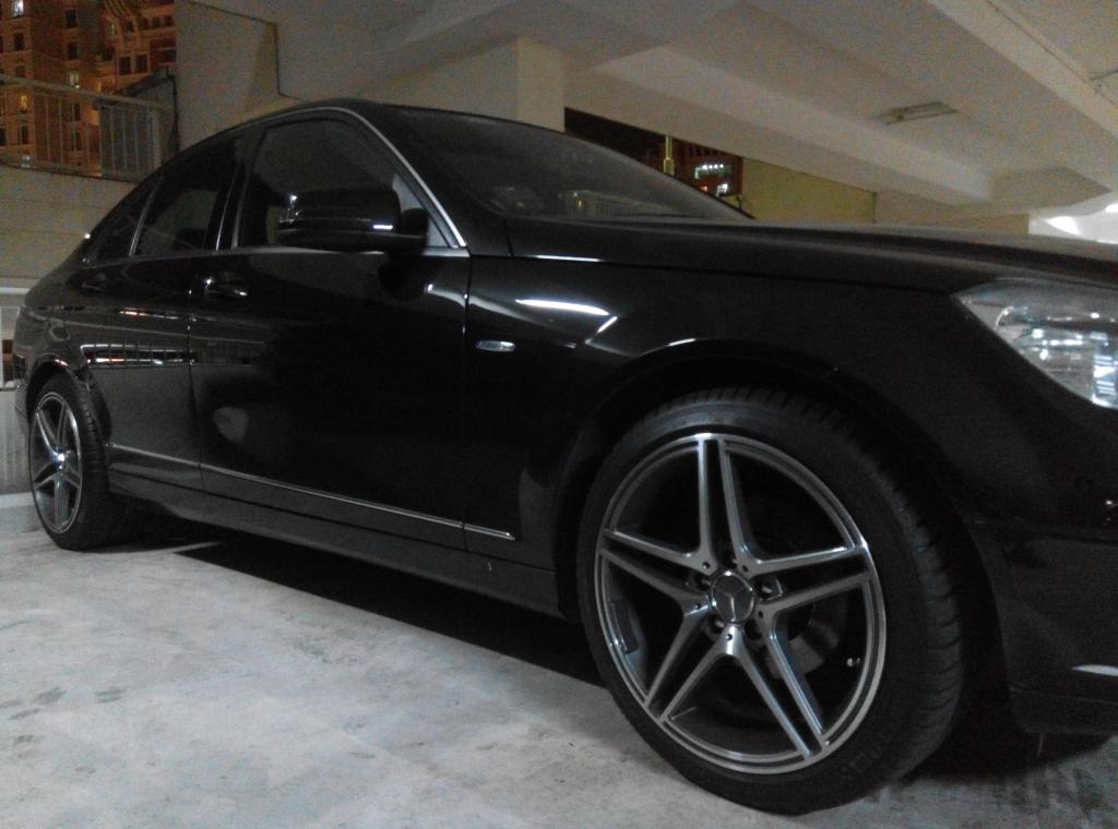

If 18 inch non staggered, recommended is 225/40/18 tyres. Safe choice for rims is 8.5.235 tyres shd b same diameter as 225 except that 235 is thicker in width when u view from back or front of car.in my opinion no point getting 235 unless going for 19 inch or staggered. Also not sure if 235 can fit on 8.5 rim.but for your case of et45 can fit 235 tyres.
