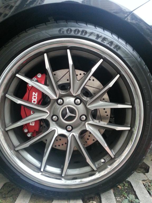

Look for euromodz they hv mini bbk to fit yr rims size. Coz yr rims just couldnt fit in the standard bbk.

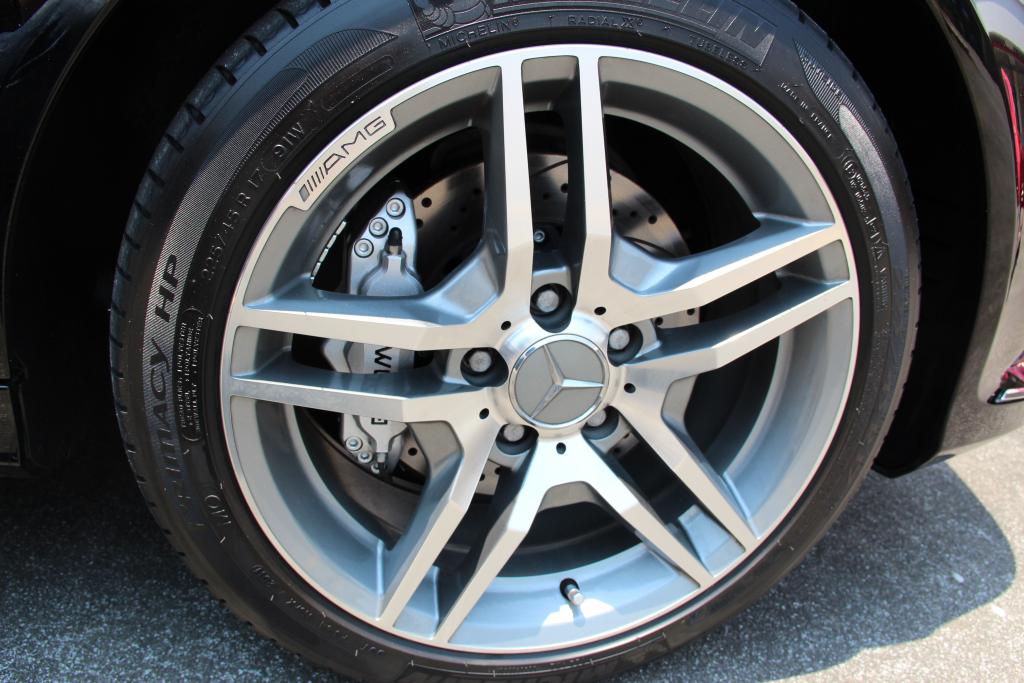

unless you are referring to this one, if you are, any idea of the price and rotor size ?

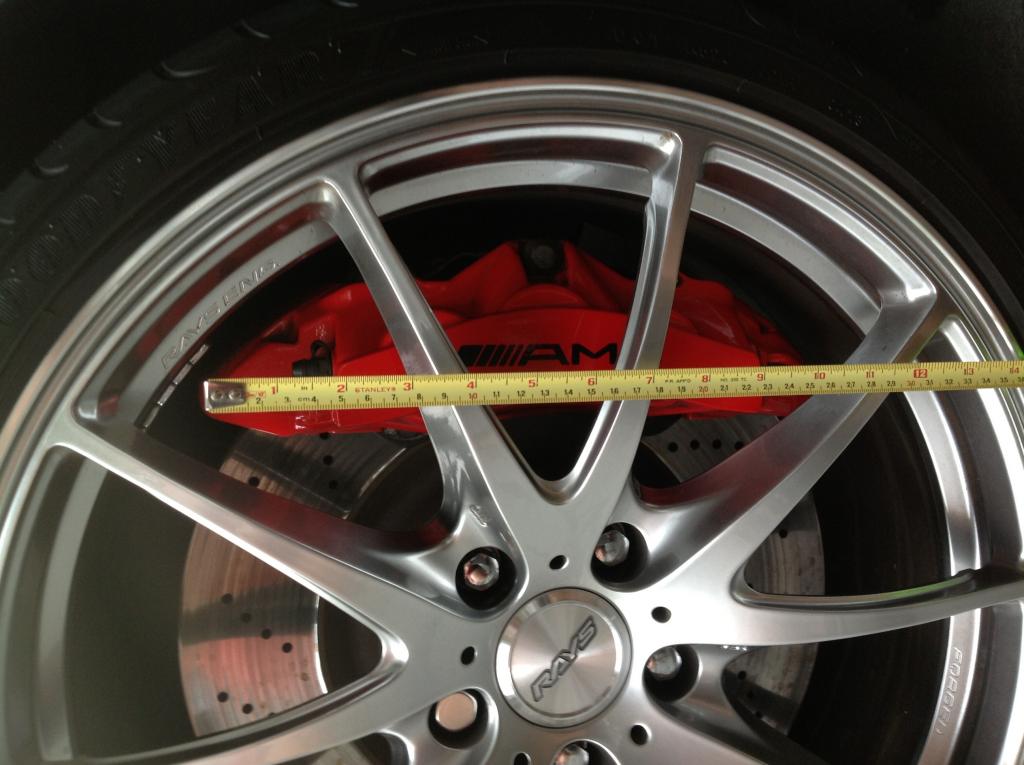

Yes...19". The caliper is definitely less than 390mm. Rotor for the frt AMG BBK is only 360mm.
Ok mate .. thx .. your help and photo is appreciated.
from the pic i can guesstimate based on 355 mm or 360 mm rotor, so long the inner diameter of the rim is more than 375, it will clear the caliper and rotor. So it will clear my rims with 17.5 mm gap between the caliper and inner of the rim since mine is 410 mm.
