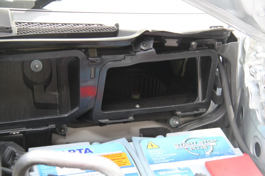

Are you referring to this box?
This box merely channel external air into the cabin.
Air is channelled from the left opening to the right opening which can open & close when u press the air recirculating button. Note that there's a rotating cylinder fan inside the right opening.

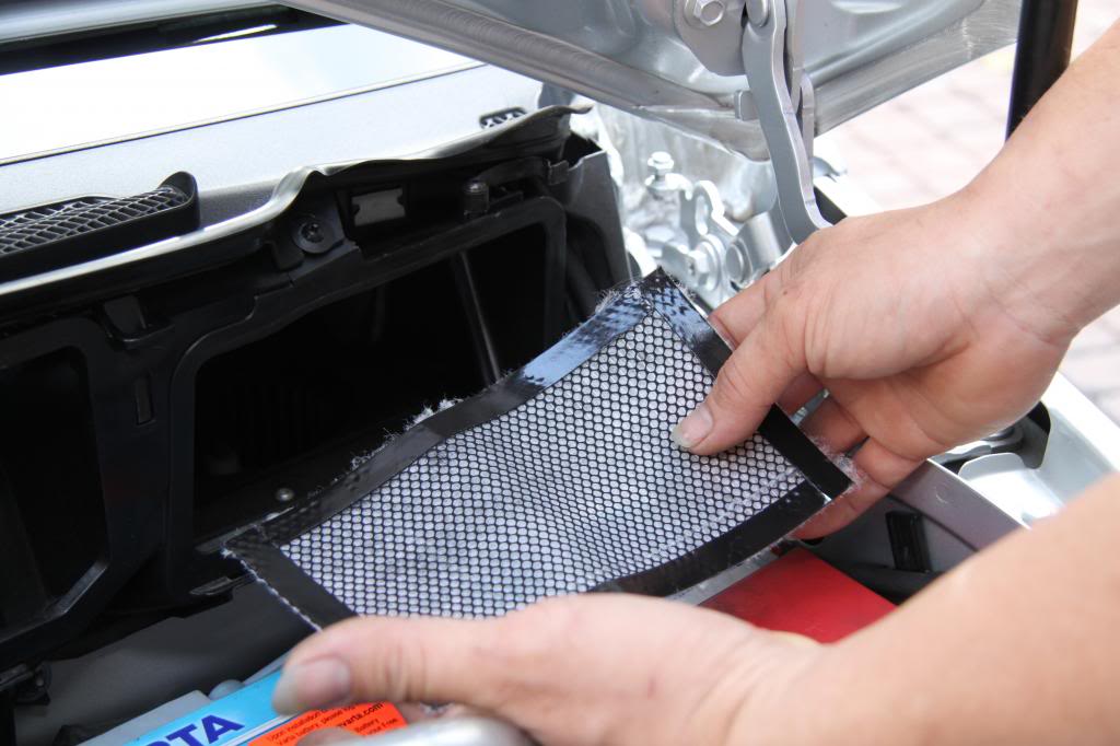

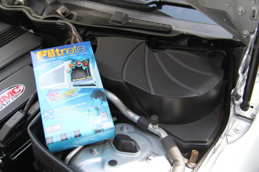

Can see that you DIY using the 3M filtrete.
Your Varta battery looks interesting too ! Which model is it?  Looks different from Silver Dynamic :)
Yes...I DIY with 3M filter in a demo that I did, so that my air recirculating button is left off all the time. Incidentally, hope you noticed that your air recirculating switches off by default after 20 mins. Don't get exos smell anymore....best of all, during the recent heavy haze....it worked very well. However, the filter needs to be replaced every 3-4 months.
