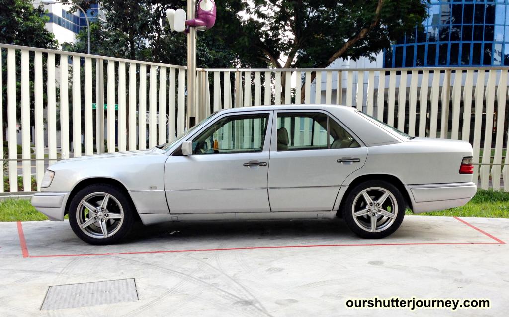

Nice rims!
From the stock tyres, 225/45/17 offers virtually no change to rolling diameter, 215/45/17, whilst listed as the official fitment for the car, will result in a small over-reading of your speedo (i.e. you will be travelling slightly slower than indicated).

Nice rims!
