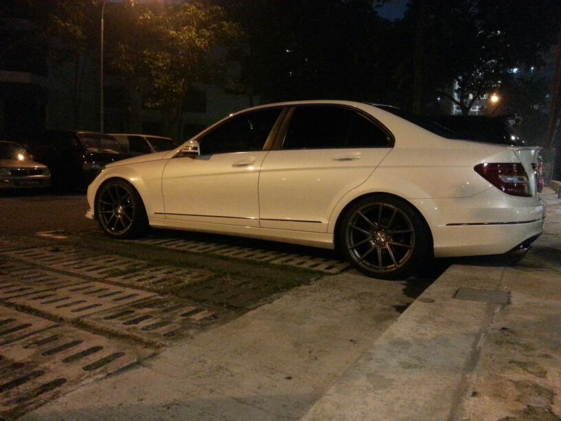

Hers a pic of mine on h&r sport springs with 19" rims. 1.5fingers all round. Depends on individual. For me i find it not low enough. Coilovers my next project. Ride comfort i find it quite close to stock. Jus slightly a little more bouncy on uneven road. Other than that everything ok.
