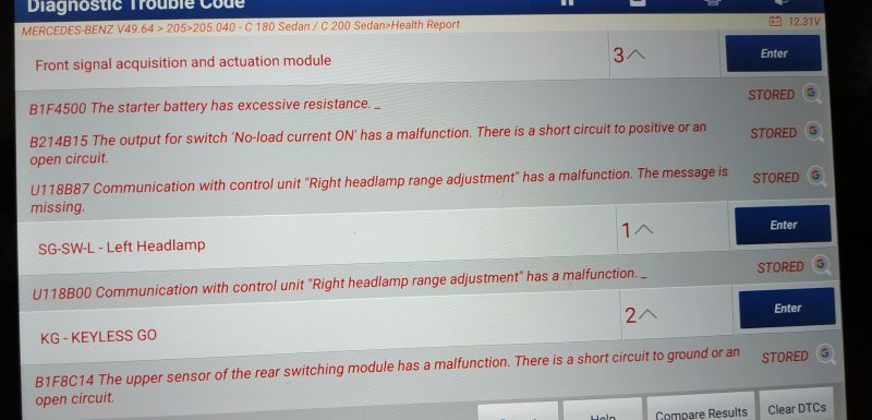

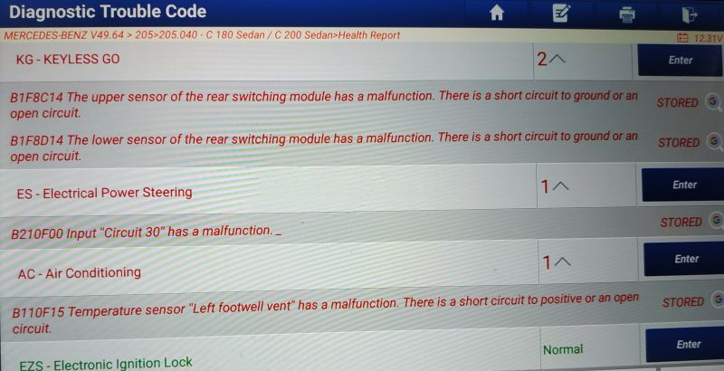

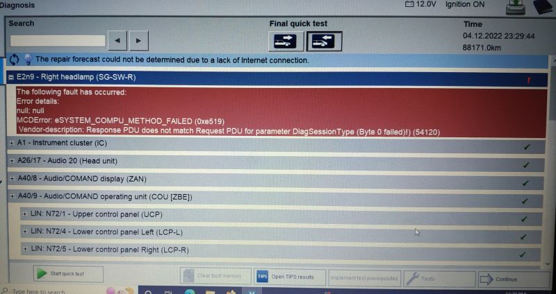

IMG_20230110_150614.thumb.jpg.f9e081751ad9430989994ab6f2db457f.jpgIMG_20230110_150543.thumb.jpg.de66ab6aa3c67a2347b08f6d533edede.jpgIMG_20230110_150519.thumb.jpg.c50f039df65828bec163b4dd7f0d4b33.jpg
Anyone encountered similar problems? No error on dashboard though errors were detected on diagnostic. Is the LED spoilt or coding issues? Can anyone advise? Thank you.

I see there are lots of electrical (short circuit) codes, and "circuit 30". Check (and replace) the relay of circuit 30, its found in the engine bay fuse box.

Not yet. I went to a few workshops including those which specialized on headlights. Surprisingly none could give me a proper and correct solution. Some said it's headlamp control unit, some said it's SAM unit. And some even asked to "try" changing headlamp control unit and if it's failed then try SAM. I also confused. I did get someone to check coding and found out Xentry unable to communicate with Right headlamp, so it seems not coding issue. I'm not sure if I changed relay 30 would it help? I tried reading the fuse diagram but not sure which is relay 30. I just worried being con by workshops as charges could be quite high if improperly repaired. And the worse is if I changed the entire headlights, the problem may still be present as it's not headlight. I am totally lost and confused. I planned to go C&C but worry the high charges. If not I'll just stick to current headlamps though I started to have dashboard errors which it didn't appear in the past 8 months.
