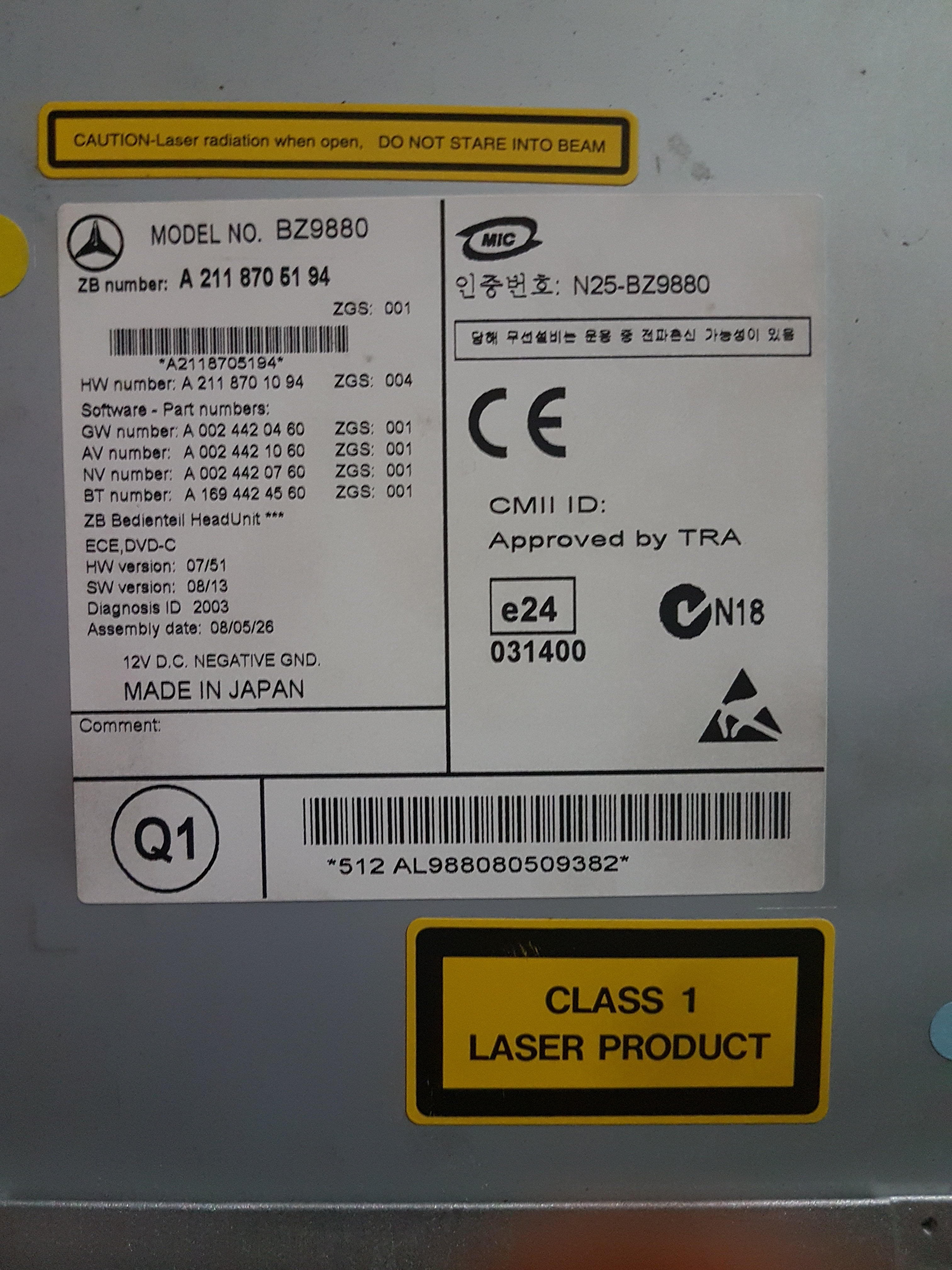

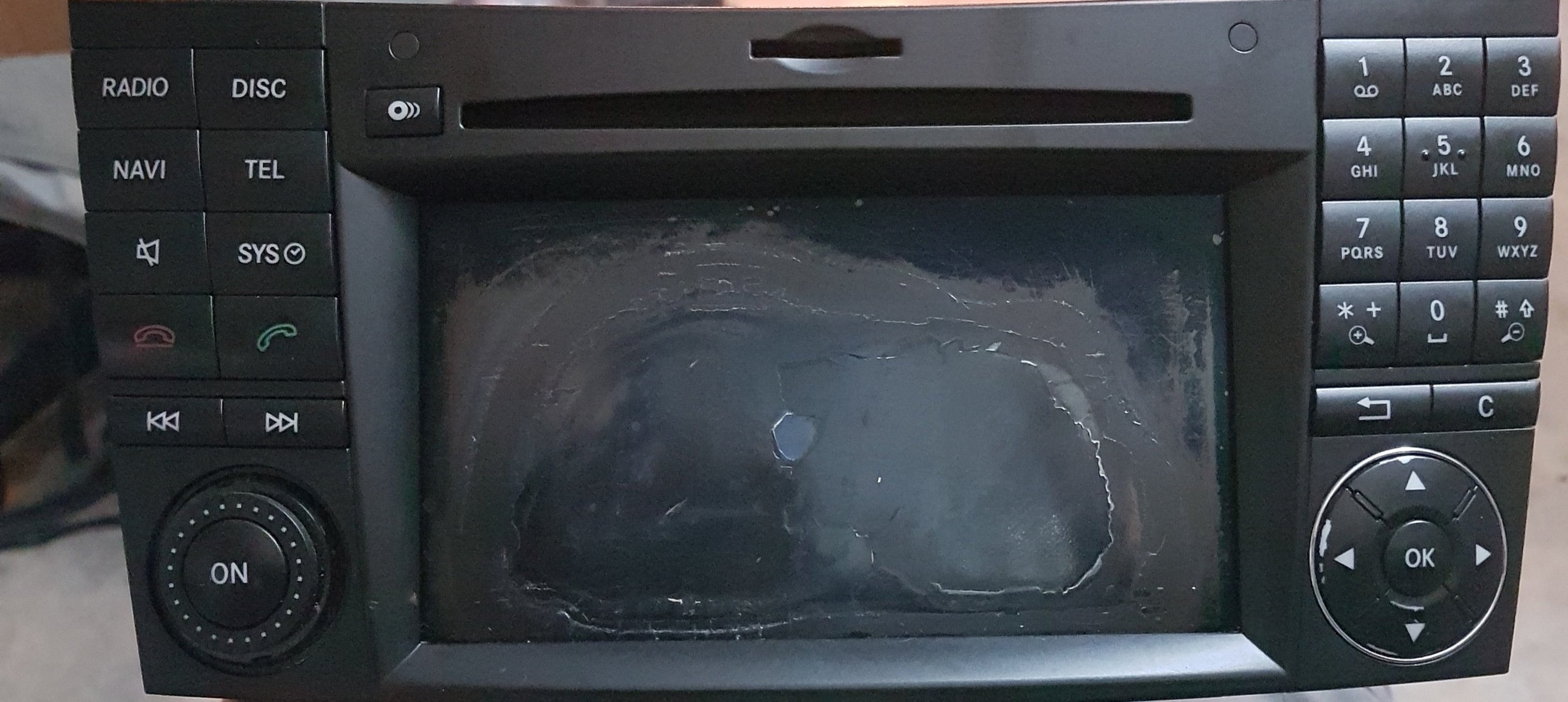

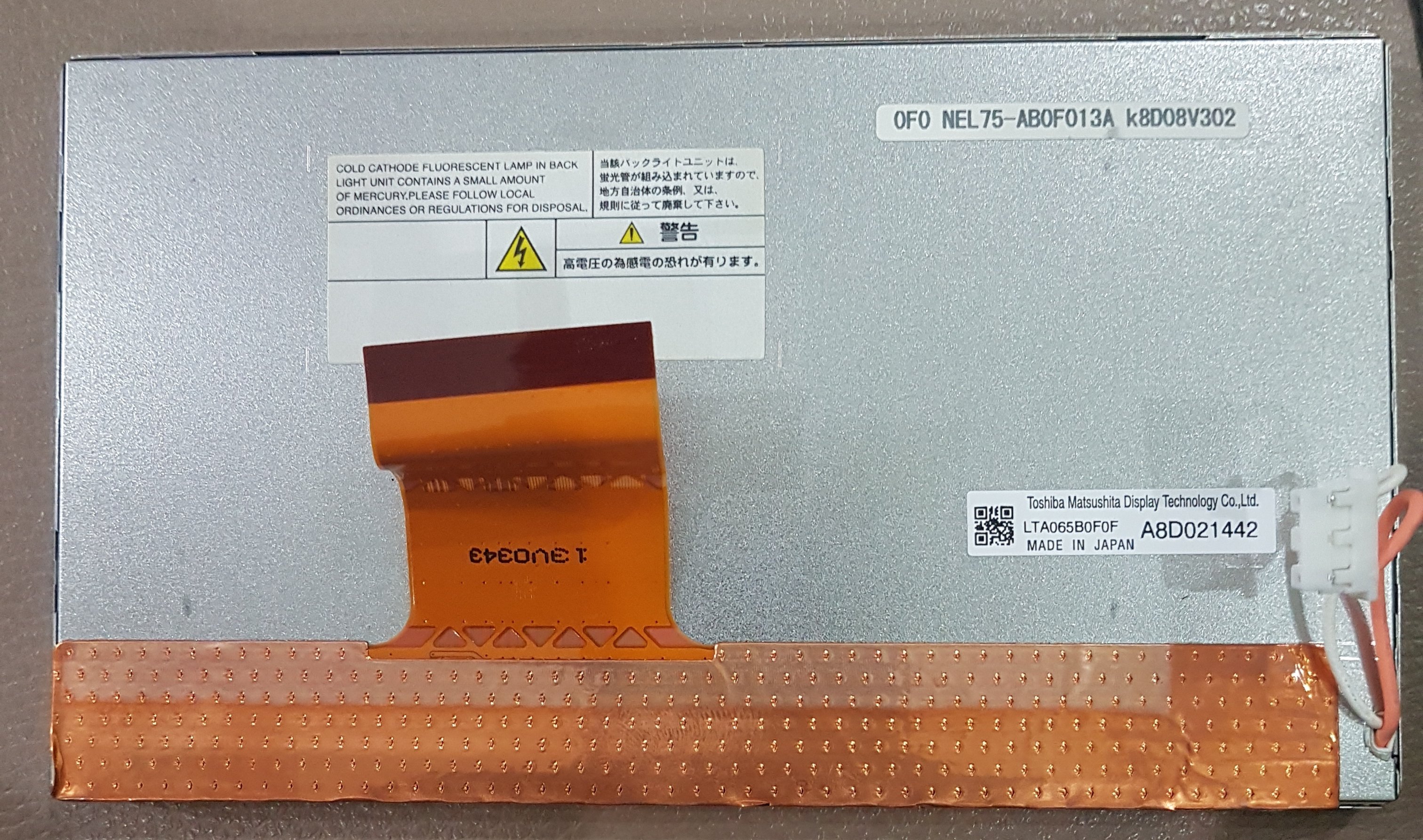

My W211 year 2009 audio has been badly disfigured. I'm willing to replace the audio with the original model or have the LCD display fixed. Can any brothers there direct me to get the replacement? I've attached my bad audio, the Model No and the LCD display which I have taken out from the system. Thanks for viewing.

IIRC, you just cannot replaced it with another original HU be it new or used as it's coded to your car.
You might able to replace the LCD display with another used unit.
The best place you can find one in Singapore is at our site sponsor Propel Autoparts, 28 Kranj Road.
They can sell you an used unit and you can salvaged the LCD screen (since you know how to take it out)
