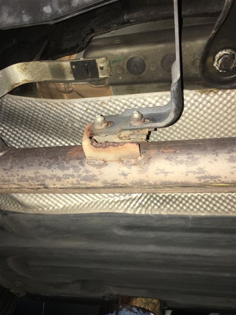

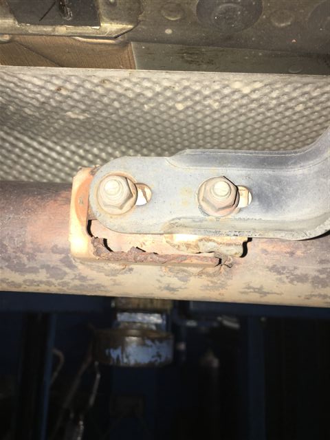

Rattling sound and vibration when engage reverse gear. Suspect the exhaust bracket broken again (workshop had it welding twice eariler !)

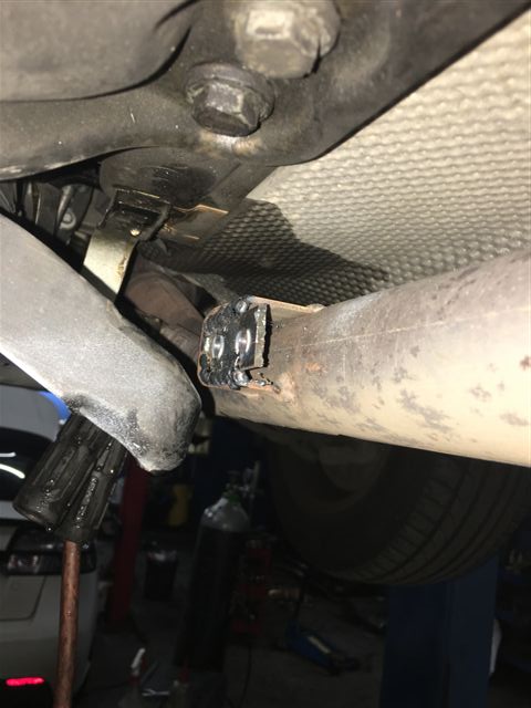

Went to Man exhaust and confirm its the issue. Mam made a new exhaust bracket with thicker steel.
Pix below (i am not related to shop but post his contact as i know many W211 owner has the same problem).
