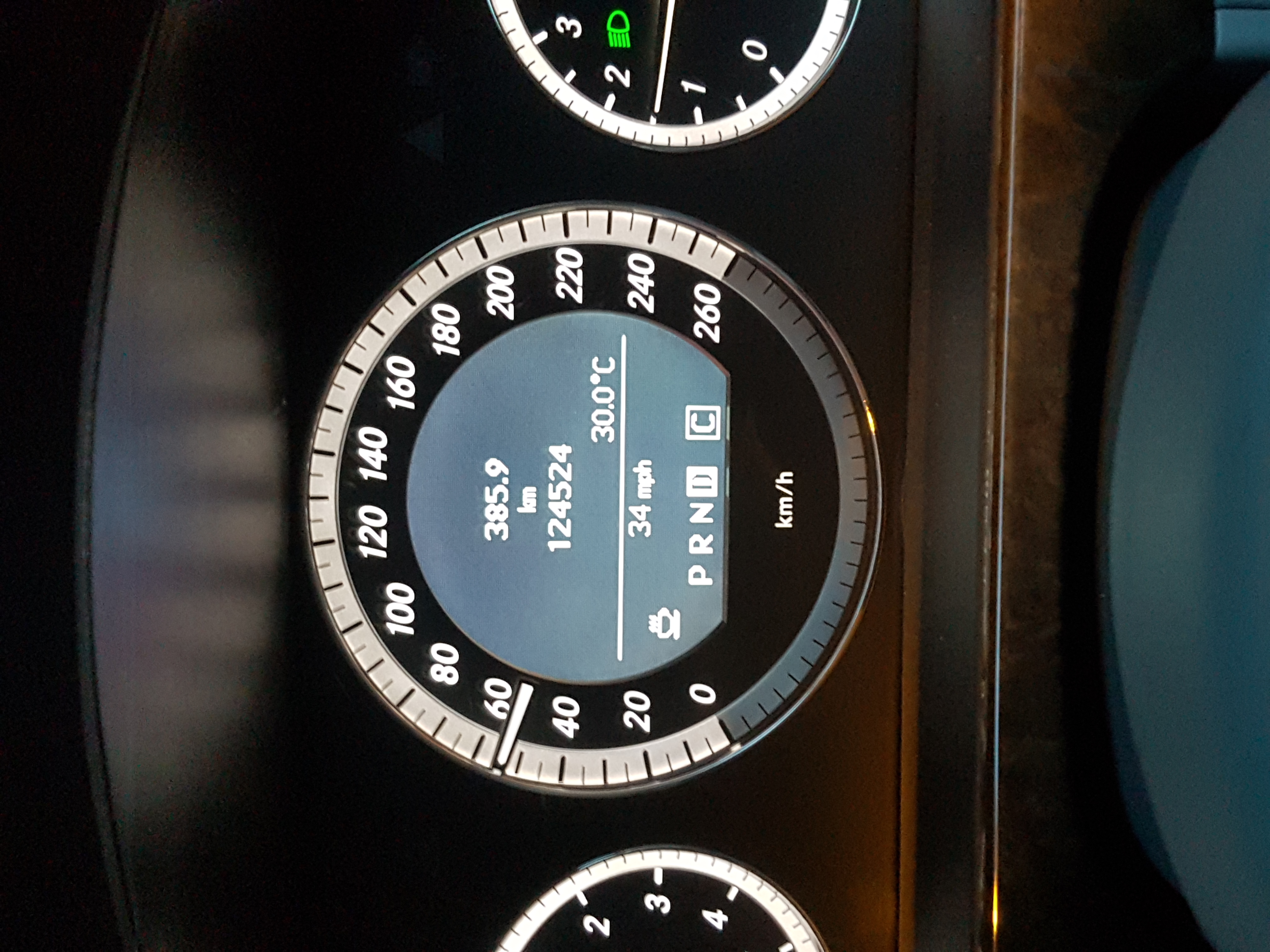

My ride is w212 year 2010
my instrument cluster display is KM but the permanent display is miles.
I have switch the speedo to Km but the permanent display of speedo still shows Miles.

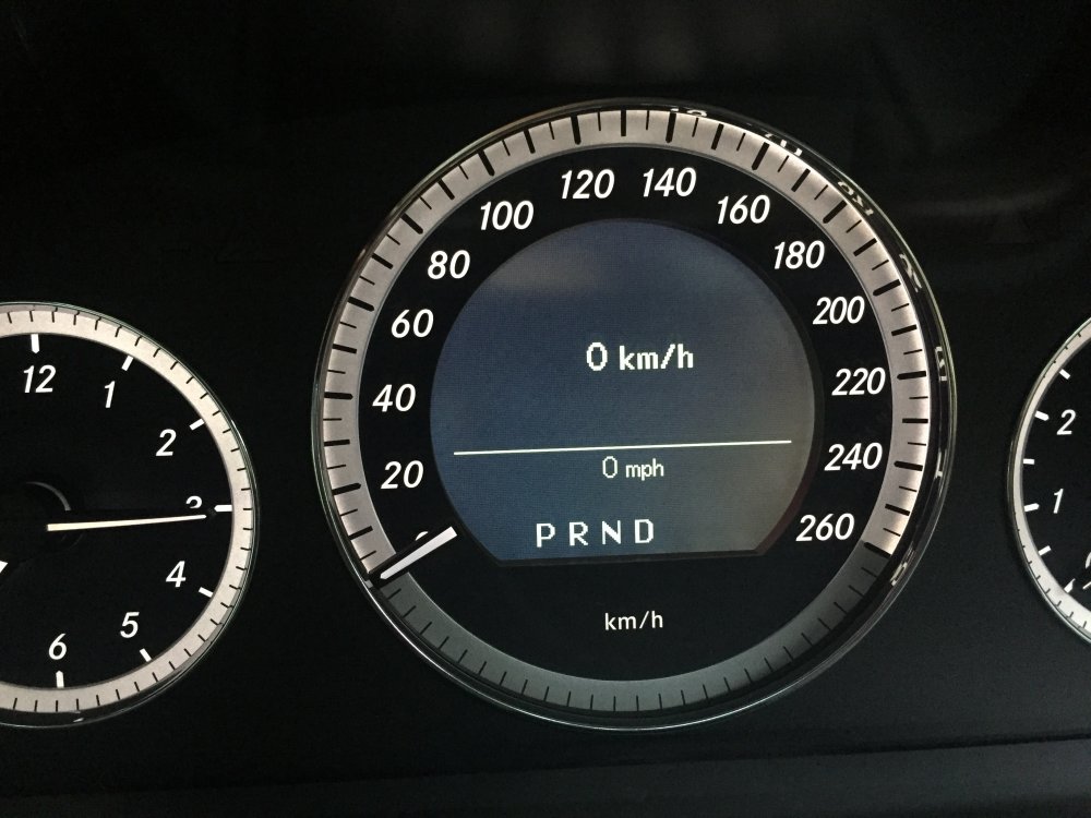

This features is useful for our foreign friend say US which used mph. So when they driving in Singapore at least they know how fast they travel in mph while the main speedometer show km/h
Cause I wanted to display the small one the kph below. The top I can display my fuel economy

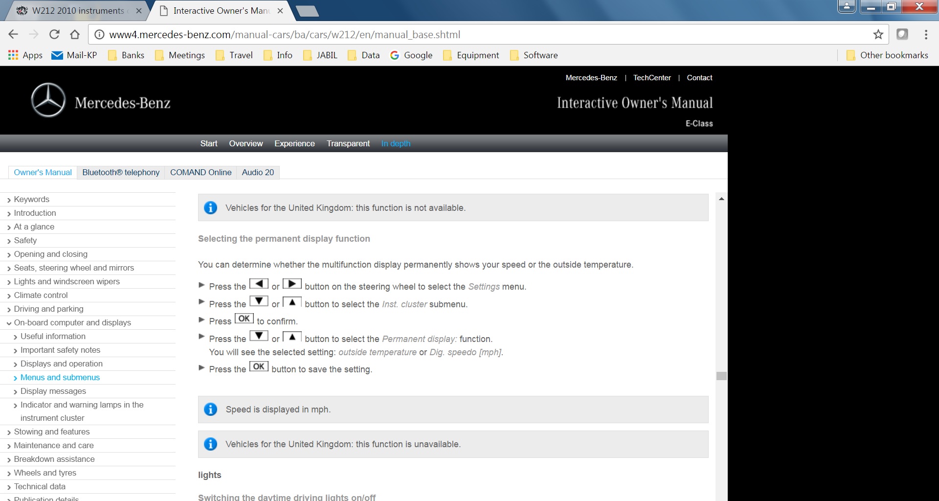

Owner Manual says the display has been configured to display outside temp and or speed in mph only.
Please read the owner manual!
