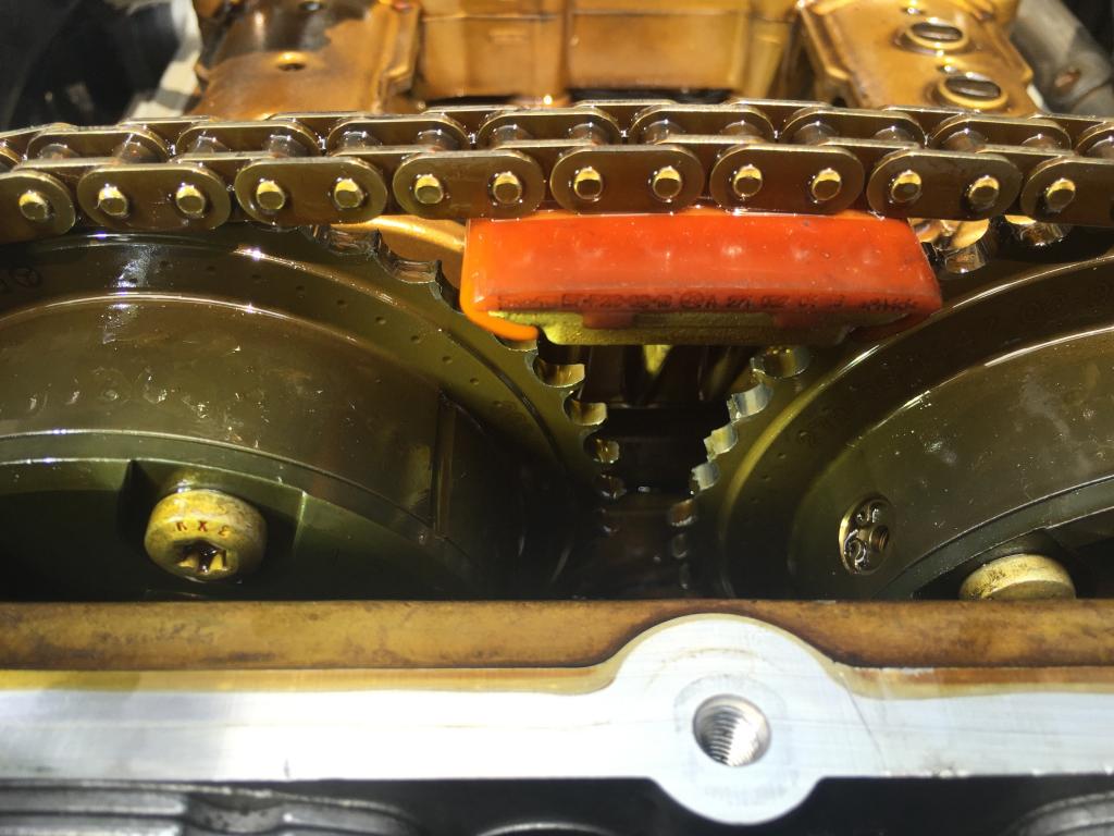

Gear issue
littlewhite
Yes, bro littlewhite, I encountered this same issue about a month ago, although no idling problem like yours but couldn't start the car at all due to compression lost according to C&C SE! Need to replace the 2 wheels with the teeths which I saw in your picture exactly like mine, some of the teeths on the wheel broke! (Sorry, didn't know the exact name of the wheel called)
This is not uncommon for M271 engine since W203 including E Class models that uses the same engine too
Google "M271 camshaft adjuster sprocket" you will see many such failures
All I can say is you are lucky to pick it up early before it causes more damage to the engine.
Looks like worn-out gears, perhaps due to starvation of lubricating oil or inferior material?
Perhaps the engine was not allowed to warm up a bit before full acceleration?
It is a shame this happens to mercedes engines!
I expect the engineering to be much better.
That is why these days I am no longer a badge-whore.

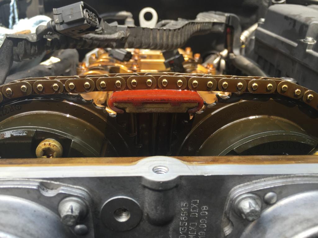

just an update......gear changed and everything is perfect now.... smooth as silk and the engine noise had decreased significantly..........
this ride had served me well and i had clocked 180k in 6 years and no major problem so far......start stop driving in singapore.....and seriously i had abused it quite a bit and i am surprised it had served me this well ;)
will be driving this ride for a another good 4 yrs......giving abit of love to it....this car will serve me well
