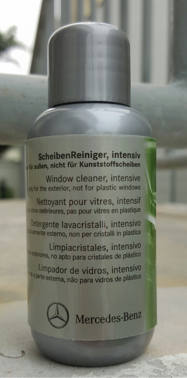

Got a bottle of window cleaner by MB, given when collect ride. Shown in pic.
I used it to clean the wind screen after shuddering and noise happens after the recent rain.
After cleaning, tried the wiper on the dry windscreen, no shudder no noise.

Did C&C give u the Window Cleaner bottle as shown above (pic i posted).
My ride is <2 mths old. After using that cleaner on the entire window screen, no longer "choppy".
It is a concentrate, just squeeze the bottle lightly to have a few drops scattered on the windscreen and use a cloth to spread and clean. Thereafter use a Charmos to finish up wiping.
Do R/L side separately.
No I did not receive this upon collection. Have they stopped giving or my agent forgot?
I find it quite ridiculous too. I used the complementary cleaner and it is greatly reduced now. I hope it lasts for me. But the wiper leaves a dried watermark like stain in the middle of the windscreen where the wiping motion ends. I had to manual clean it to have a clearer vision. Sigh ..
