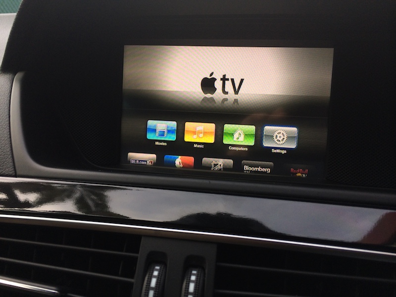

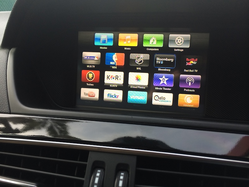

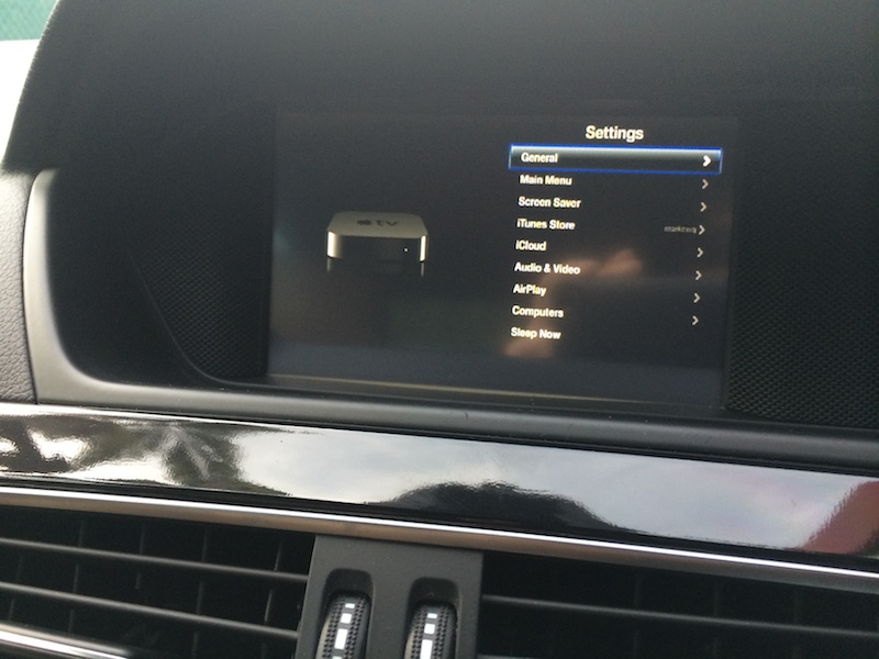

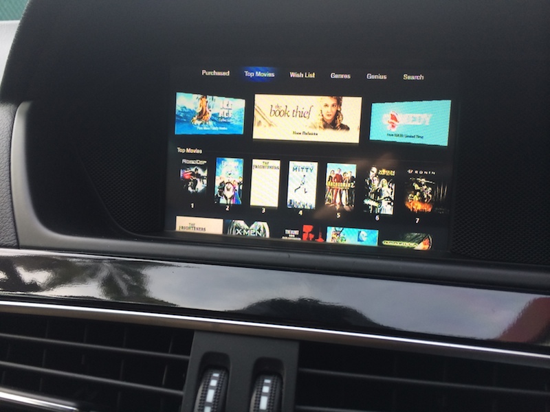

I researched online and bought the Apple TV and all the necessary items such as video and power converters myself. Got my usual mechanic (Ah Boon fro AutoSpritze) to install the system for me today. Downtime was roughly 4hrs.

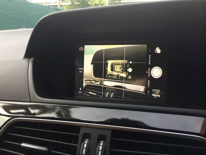

Very useful for those who use Apple products and have an iTunes account. Don't need to install third party aftermarket GPS anymore, just mirror the GPS from the iPhone or iPad.
iPhone, iPad, MacBook (AirPlay) mirroring!

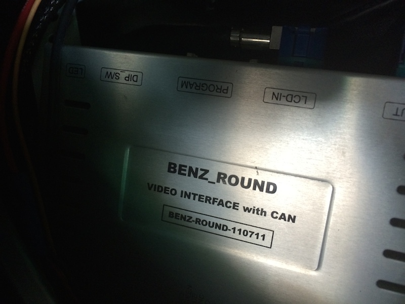

The video cable connects into an aftermarket Video Interface (see pic) which projects images onto the screen. The video and audio cable does not plug directly into the HU. So which ever HU you're on (Comand or Audio 20) shouldn't matter. Anyone who has an aftermarket reverse camera will have a Video Interface in their car.
In theory, the video input from the Apple TV works the same way as the video input from the reverse camera. If you can project the video feed from the reverse camera, why not from the Apple TV?

I mainly use it for it's AirPlay mirroring capabilities. I have one in my home and thought it'll be nice to have it in my car as well.

I got a 200W converter, it's good enough already. I already had a video interface located in an accessible area so decided to plug there instead of dismantling the Comand HU.

Of course reverse cam still works. You can plug in multiple video devices into the video interface.
