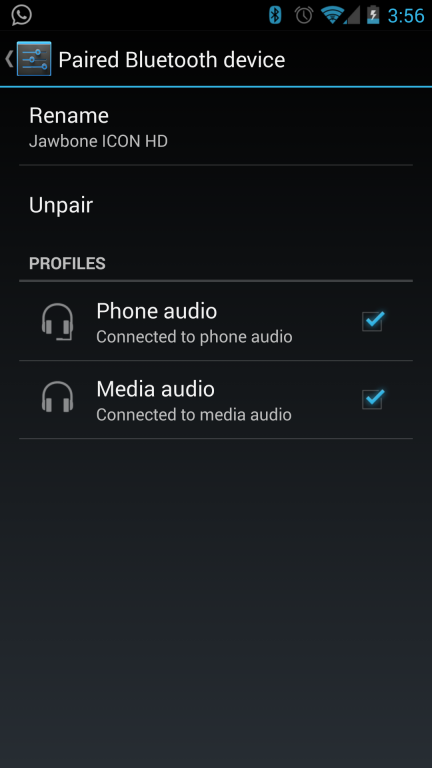

Actually with most modern phones, it is possible to connect to multiple bluetooth devices as long as the bluetooth profile used is different, and that’s what I’m currently doing on my W204.
For example, my phone is connected to the car’s bluetooth telephony service using the Hands-Free Profile, also known as Phone Audio on Android devices. At the same time, it is connected to the Bluetooth audio receiver using the A2DP (Advance Audio Distribution Profile), also known as Media Audio on Android devices. All I need to do is to select the correct profile for the bluetooth devices on my Android phone. An example screenshot of how the settings can be toggled is attached. I believe a similar setup is possible on iOS devices (might not be true).
