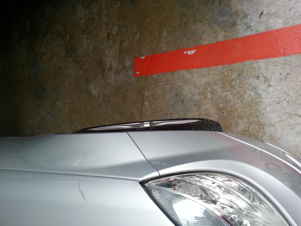

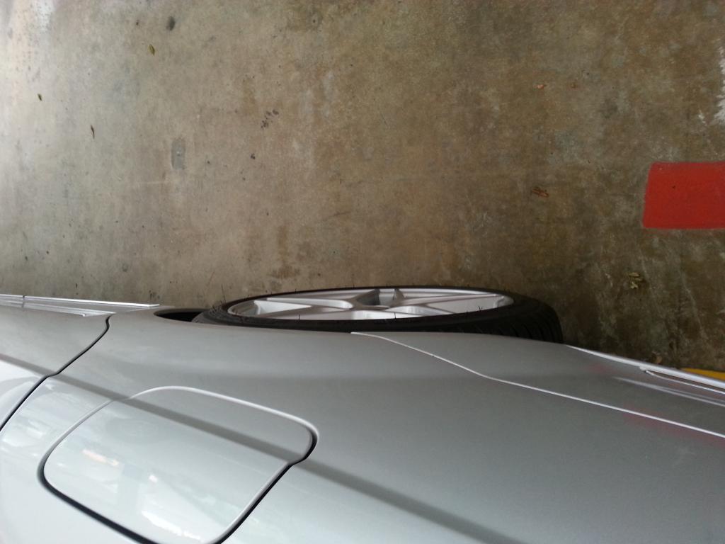

check out my post:
http://www.sgmerc.com/topic/8751-show-us-your-bbk-rims/page-16
nicely flushed with the fender.
