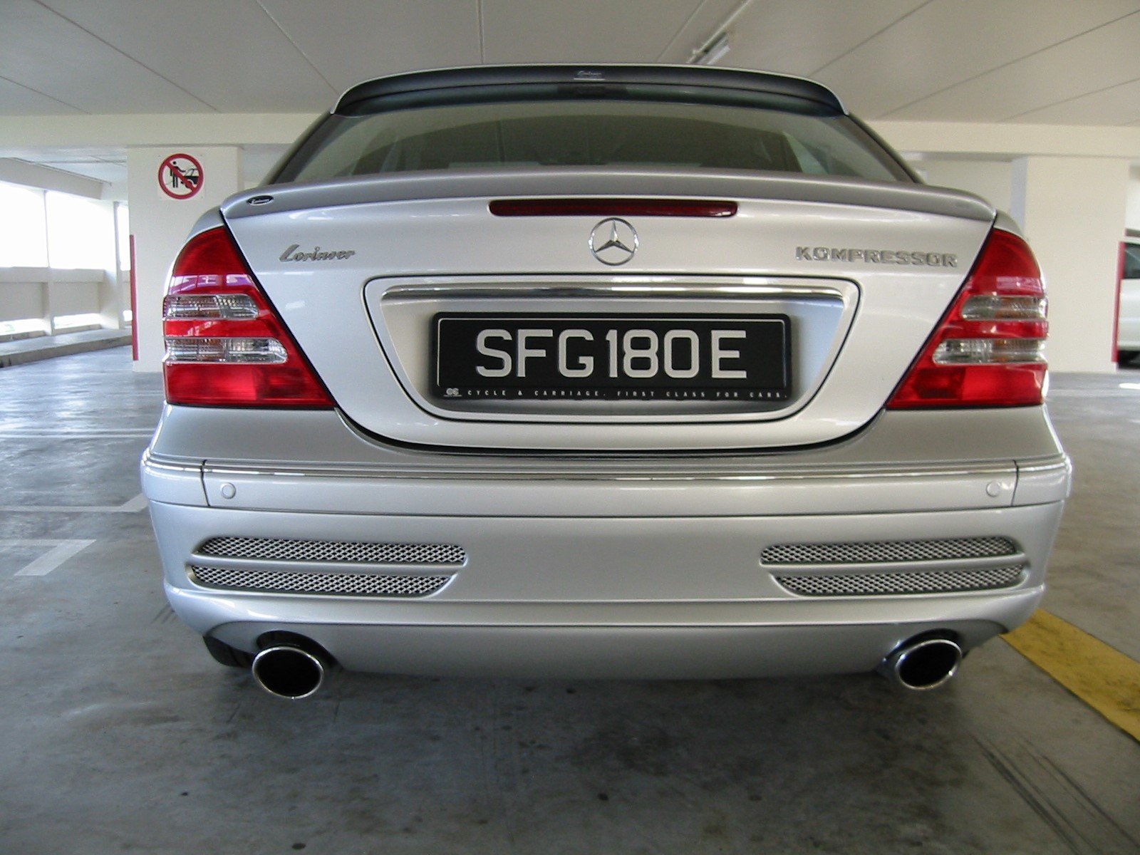

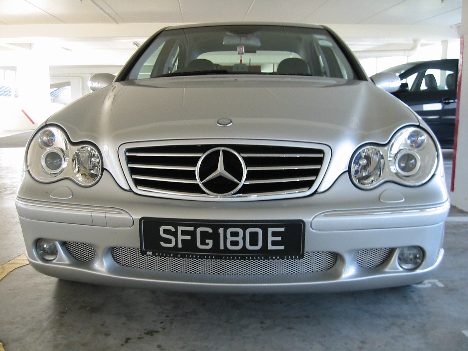

One of the better looking W203 at that time on the road (see pictures below)rear.thumb.jpg.a086202e27d8dd5bf821b004246b7349.jpg
That time young like most here want more hp & ride to look good
Changed the following on my W203
1. Changed C180 Supercharger to C230 Supercharger (MBM)
2. Kleemann K Box with pulley kit with K&N air filter,  bigger fuel pump, Kleemann down pipes, (MBM)
3. De-Cat (MBM)
4. Lorinser twin LTA approved exos (Benzline)
5. Heller Bi-Xenon Headlamps (Benzline)
6. Full Lorinser Body Kit (Benzline, sprayed painted by TCL Spray Painting - the infamous Ah Long)

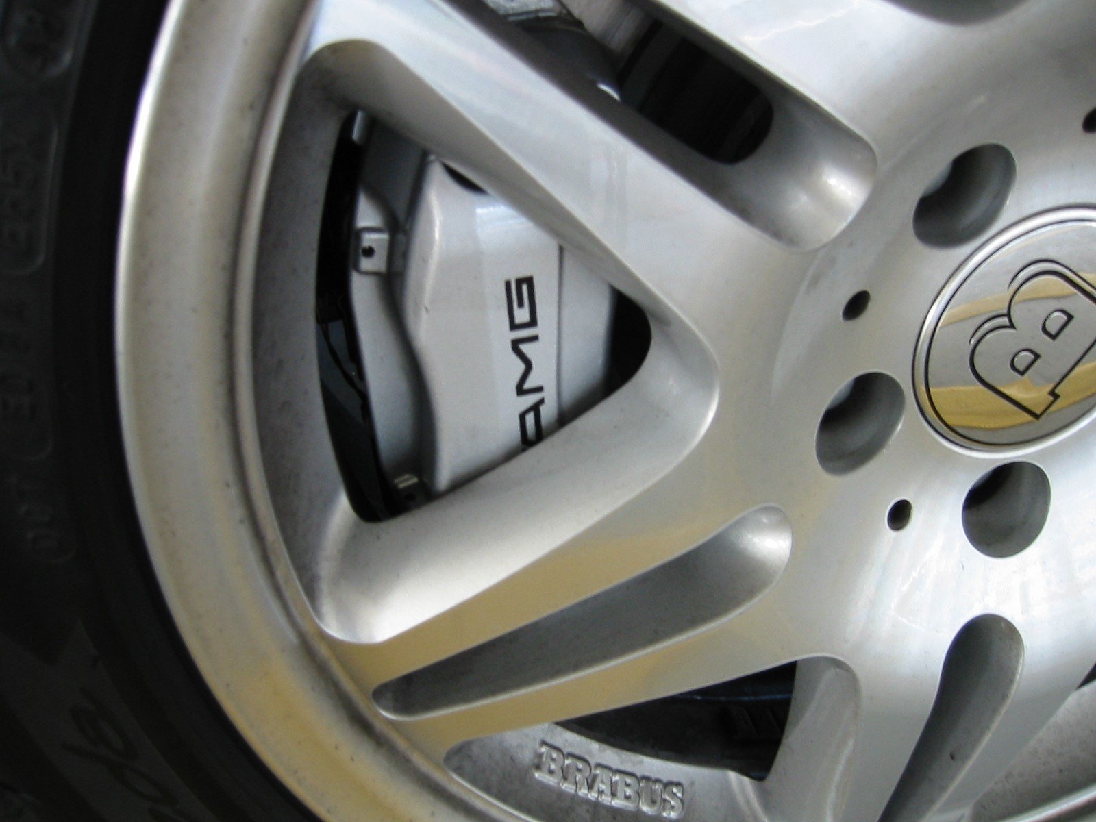

7. Brabus Monobloc Rims (Benzline)
8. AMG Front BBK (Benzline)
