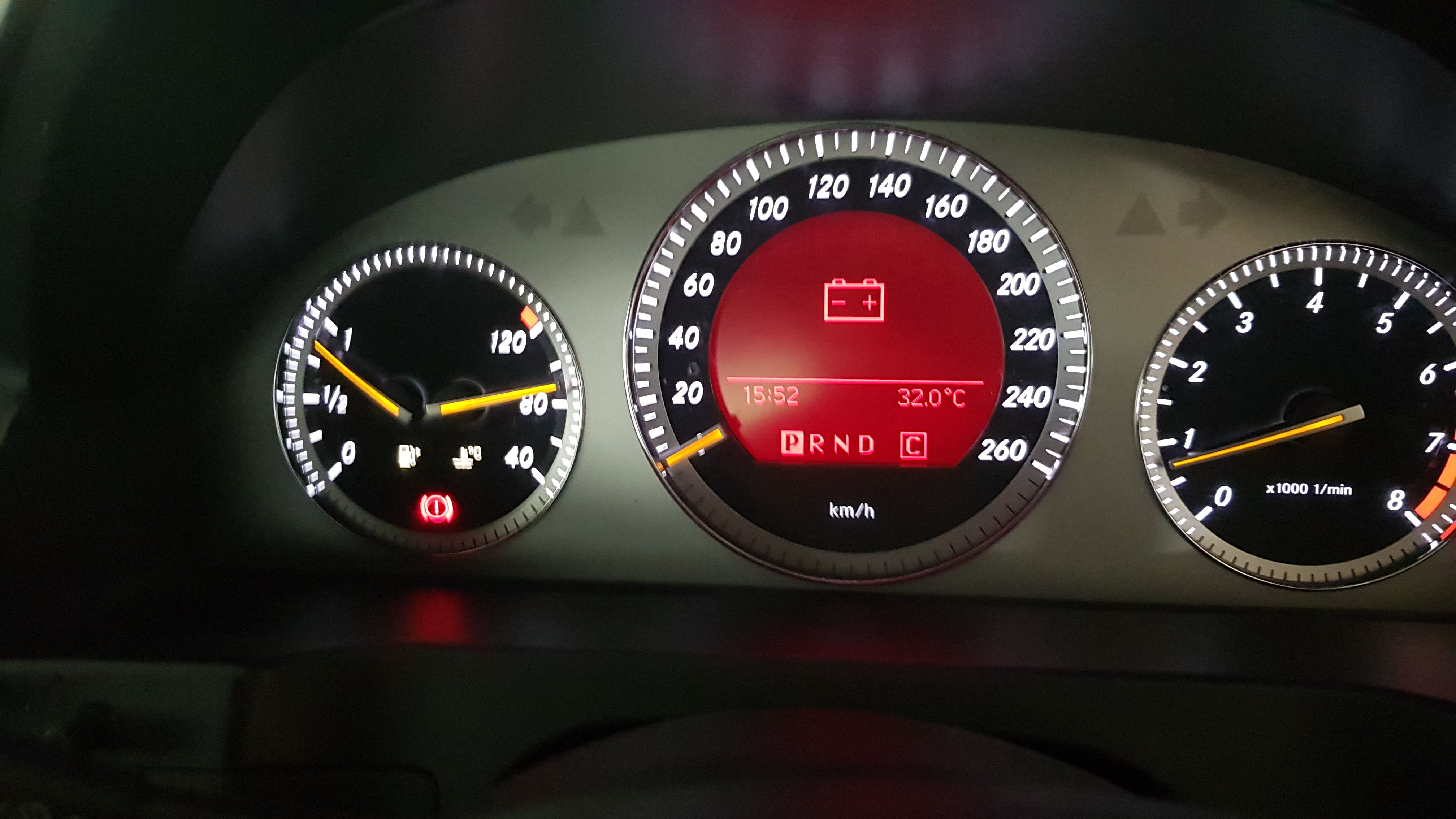

New bird here who is in need of help! Currently, i am driving a w204 c200 kompressor model'08. The Battery Sign appeared on my car this evening, was wondering whether Is it battery low or alternator problem? The Battery was last changed in Feb'17.
Lets say if it is alternator problem, do you all suggest getting a OEM/Recon set or just repair the alternator? And any idea what is the average price for each?

did u see this message just after you crank up the engine or during mid way driving?
Actually you can check the battery voltage/ charge level on this car easily...
1. Pre condition :Engine is stop
2. Insert key, turn the key one step(without cranking the engine)
make sure the dash display is at home menu( without all those warning message), if u hv some warning msg, just clear it out by pressing return key
3. Press /hold the phone pickup button- (right steering keypad), follow by ‘ok’ on left steering keypad and hold these two buttons until dash display change
4 select “vehicle data”, it should display voltage...and ampere..
5 start the car normally.... u should be able to see the battery voltage and ampere... and if system is charging , the voltage should be >13v, and the ampere value should be dropping slowly while u driving....( as the battery charged up)...
