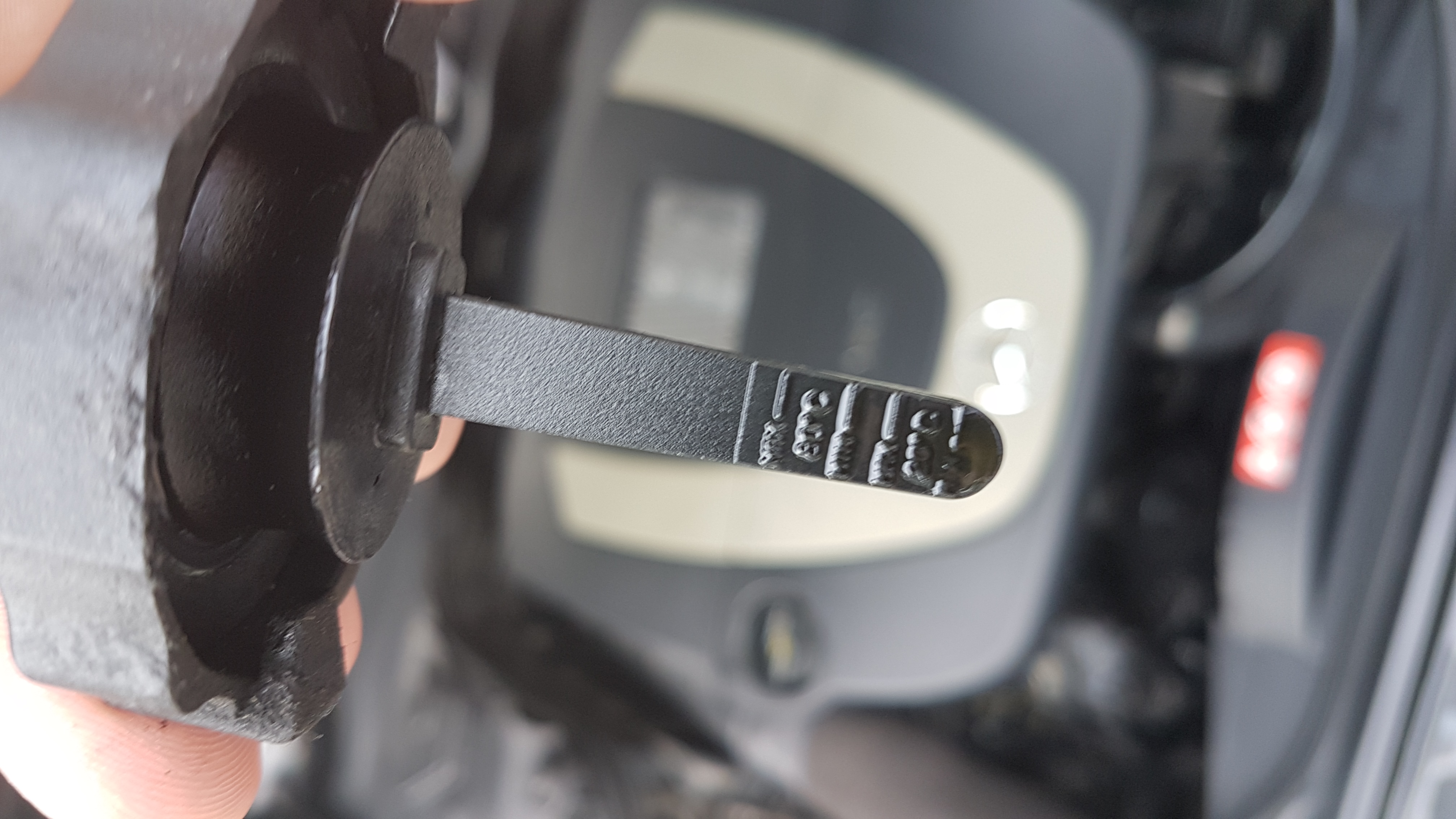

Hi,
Mine W204(m271), the power steering fluid level is @ 20c max level..even after long driving .. I think is rather low (correct level should be somewhere between 80c min/max .. Power steering sometime few heavy, sometime very light feeling ..
Just bought 1lit from Goldenlink (A001 989 24 03 10) $24 .. will do a simple siphon & refill later ..
regards

Hi
Just completed siphon out ~ 450ml using shampoo dispenser, the old PS fluid came out  dark brown in color, pour in the MB345 (green ) ,  close to max level ..  Did a quick test, steering now much lighter ....will monitor tomorrow ,,
My steering so far is smooth, no noise ... just that sometime feel heavier than normal .
Will do another round of siphon + replacing weekend ... to further clean up more old PS fluid out.. since I still have ~ 500ml left .. :)
Well, it's a quick night job ... no harm spending $24 'replacing ' the PS fluid using this method ..
regards

Checked P.S. fluid level this morning and seems to be ok but feel it's on low side
