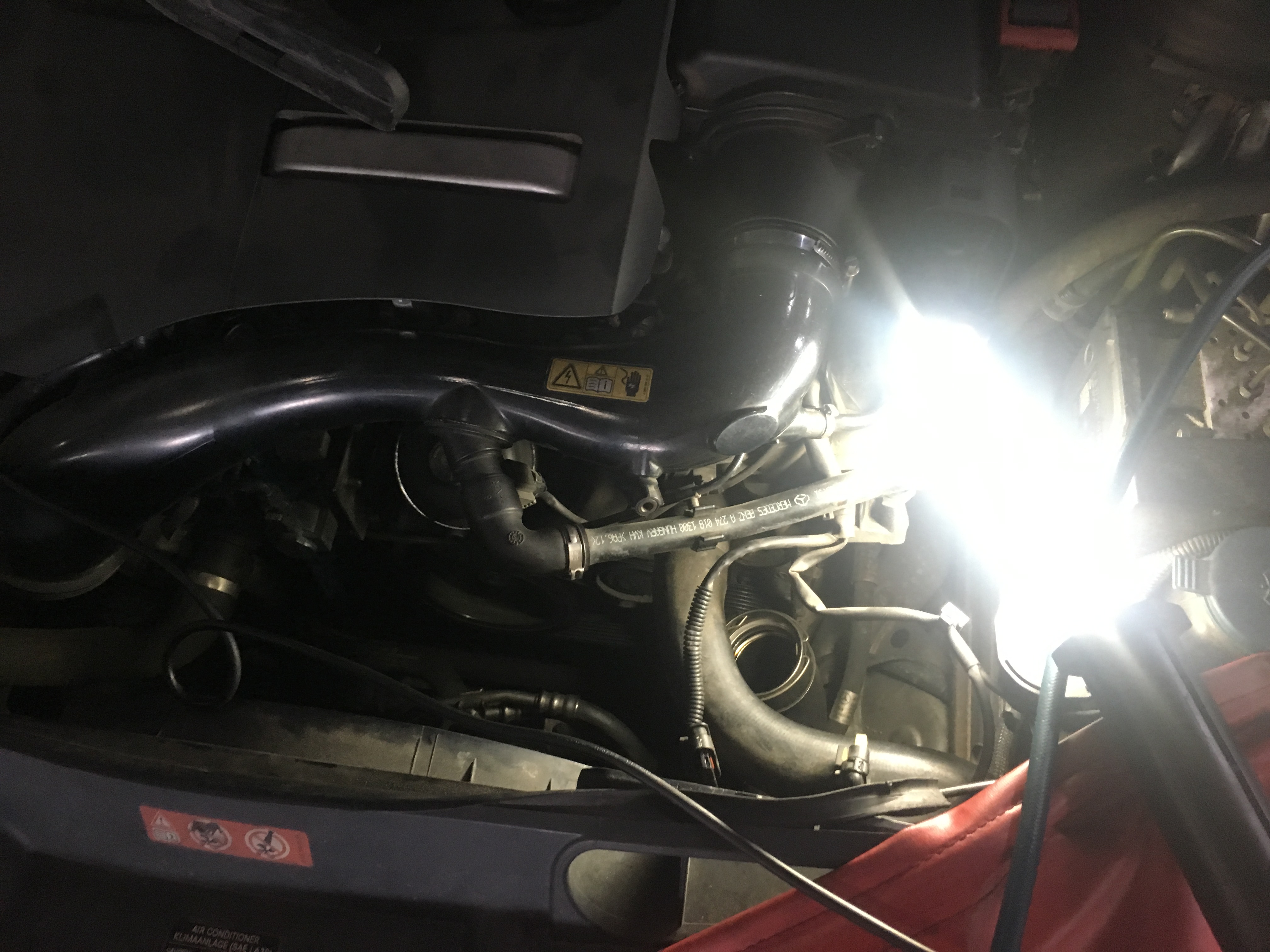

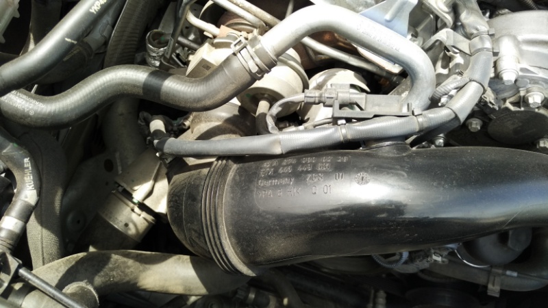

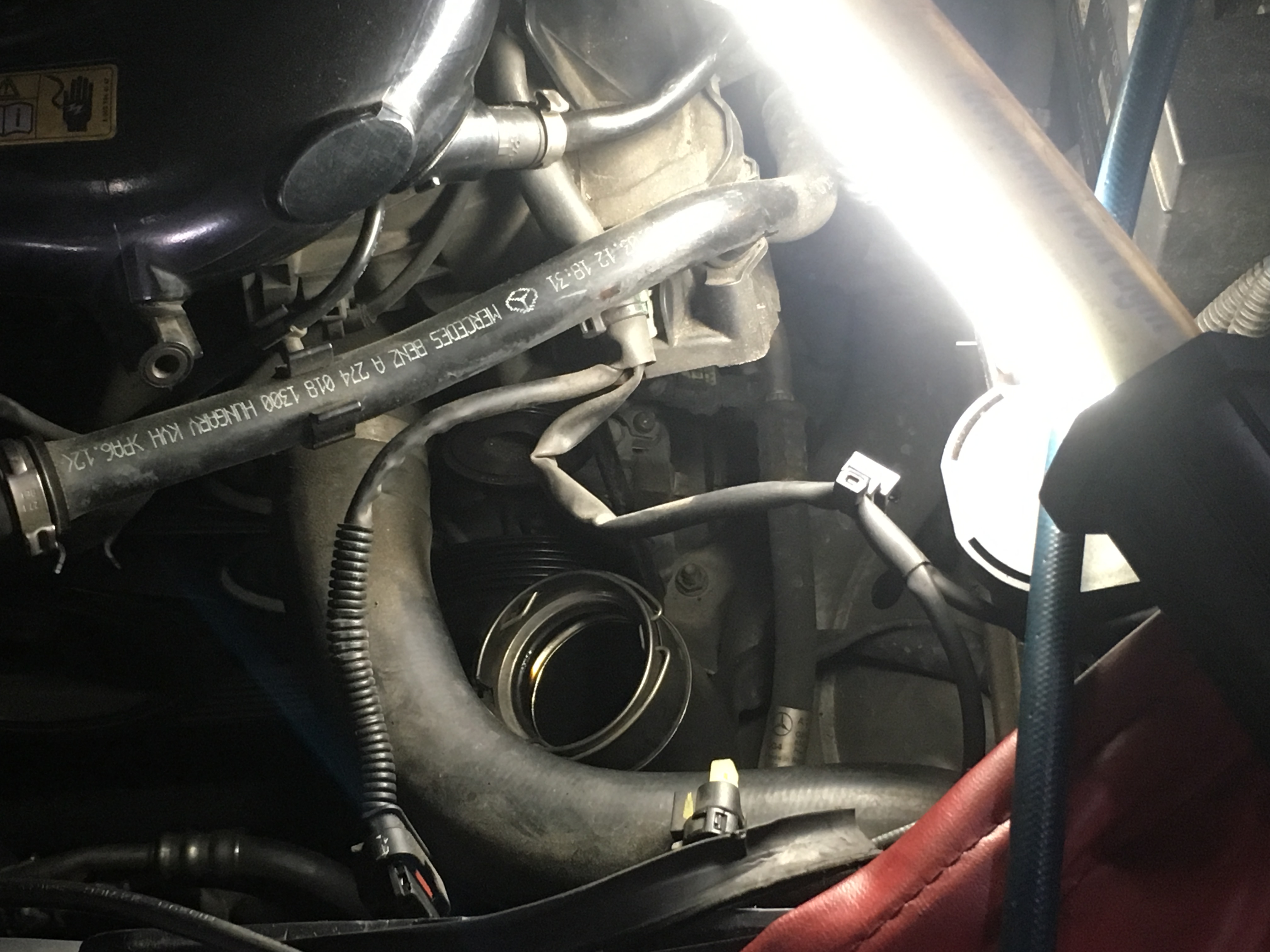

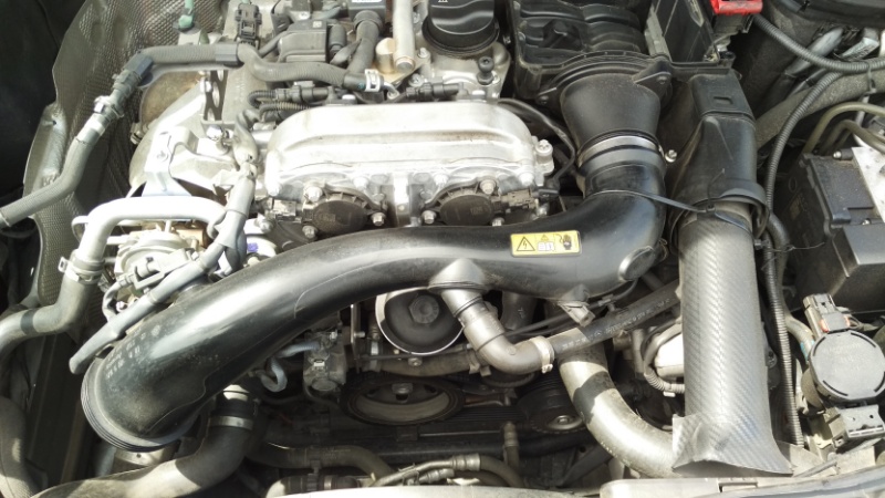

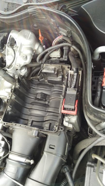

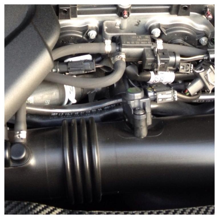

any bros here can help identify where is the maf sensor on 2012's w204 1.6 turbo engine.
attached 4 images in the post.
1st is overview of engine compartment with air intake in the center.
2nd is air intake box without the air filter (I read that w203 has its maf sensor at the rear of this box, so I opened up on my w204, it's not there)
3rd is bottom left of the air intake, I think the connecting clip is o2 sensor?
4th is bottom right of air intake.
Please point me in the right direction.
Thanks in advance!
