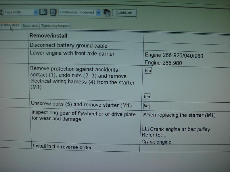

Now preparing my wallet to get the Starter Motor replaced which entails drive shafts removal, lowering of the transmission and motor to be able to get to the starter which is mounted ontop of the transmission housing, which happens to be just under the floor. (Don't you just love german engineering) Yah das is Rad! (Approx 2K to do the job),
Perhaps MB chassis engineering should have considered a access hatch for servicability........perhaps not...... Part of being a B-Class owner
Even if it is simple as the starter solenoid issue or carbonised brushes, the motor and transmission need to be lowered from their mountings just to get to the x3 recessed bolts that hold the starter in place.

*Note: images courtesy from WIS from bro eric242340 off Benzworld.org
