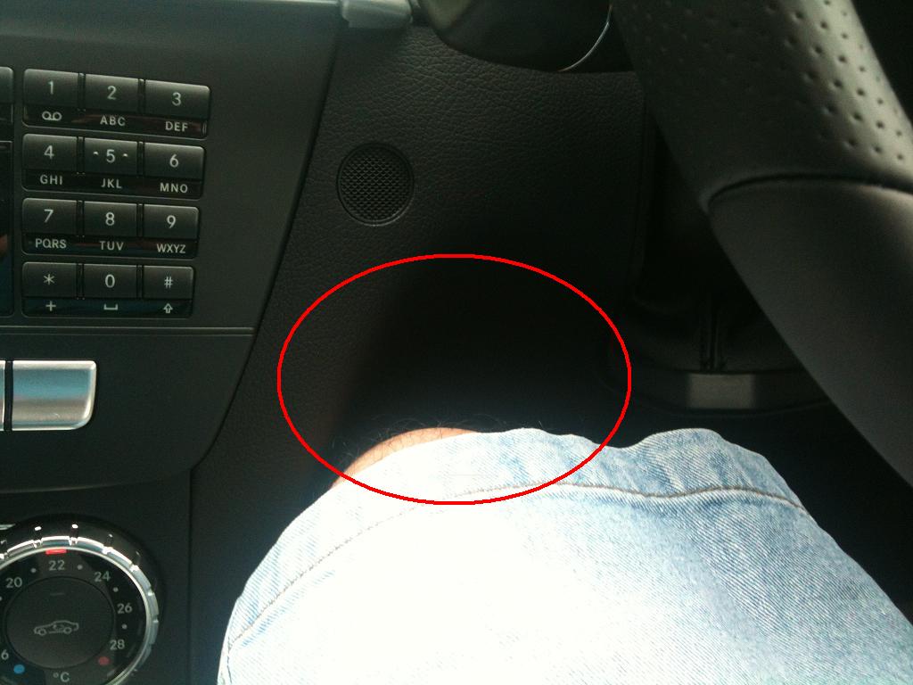

After diagnosing the ticking sound problem, manage to zero into the main cause of the sound. It's from the lower right hand side of the dashboard (beside the aircond temperature dial - see photo attached circled in red, pardon my sexy leg) . Usually, we will rest our left leg on this part when driving, especially those with long legs. If you just apply some pressure on this part, you will hear lots of tick and creak sound due to plastic rubbing plastic. If you rest your leg on this part when driving, you can hear ticking sound when going through uneven road, as your leg is applying pressure on this part when the car is bumpy.
All you need to do is add felts at this part, don't ask me how, I just get C&C to do it for me. I also did the same part on the left front passenger seat side (in case I need to fetch some long legs ladies :P)
No more ticking sound for me now. :)

the ticking sound started again and i moved my left leg away from the center piece, and the sound disappears. hayato you are right. thanks bro.
Perhaps you can ask C&C to add some felts at that area when you send in your car for servicing, but I recommend you to go to Pandan Loop, cause need to ask the body & paint section to do the job.
