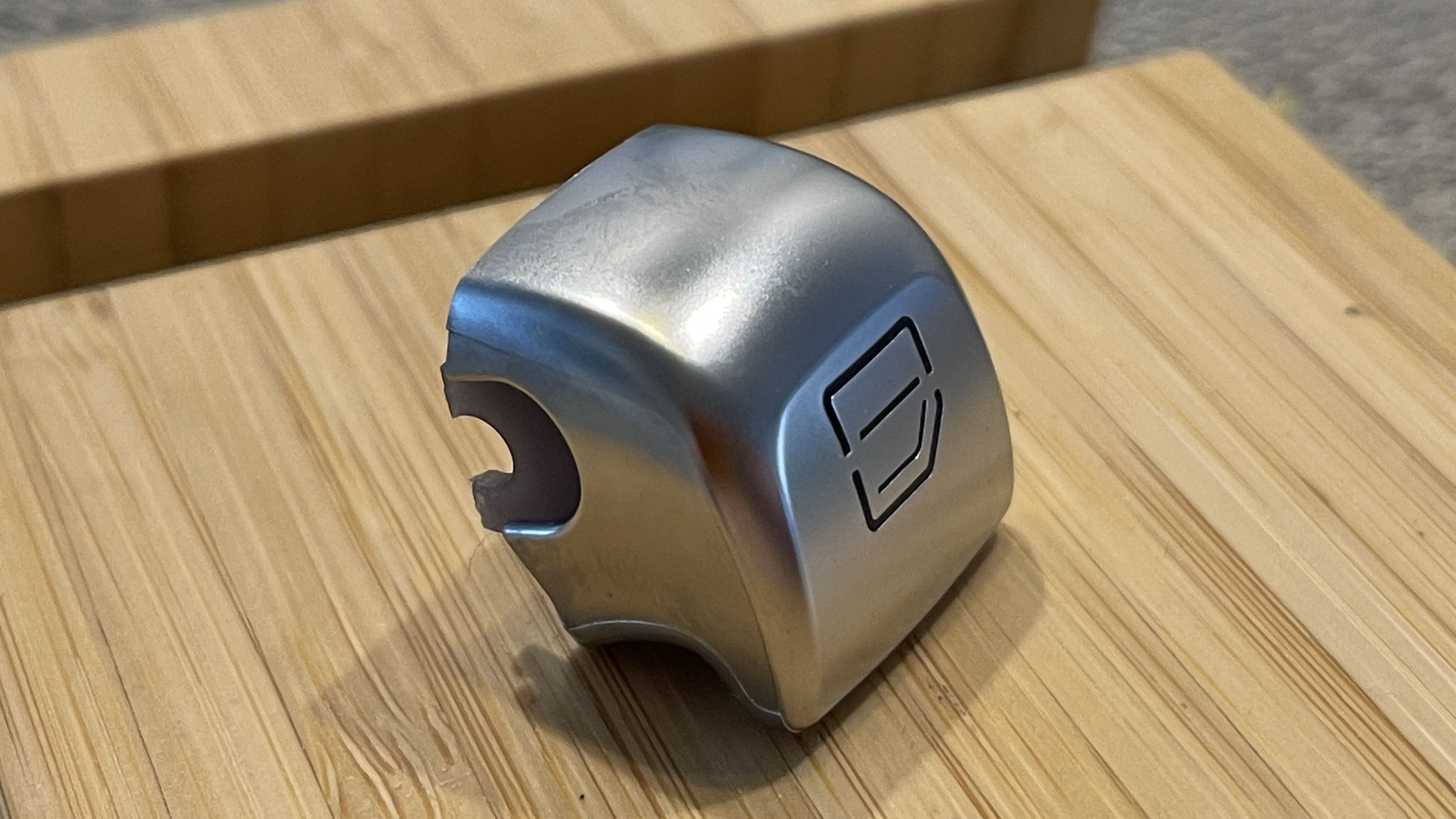

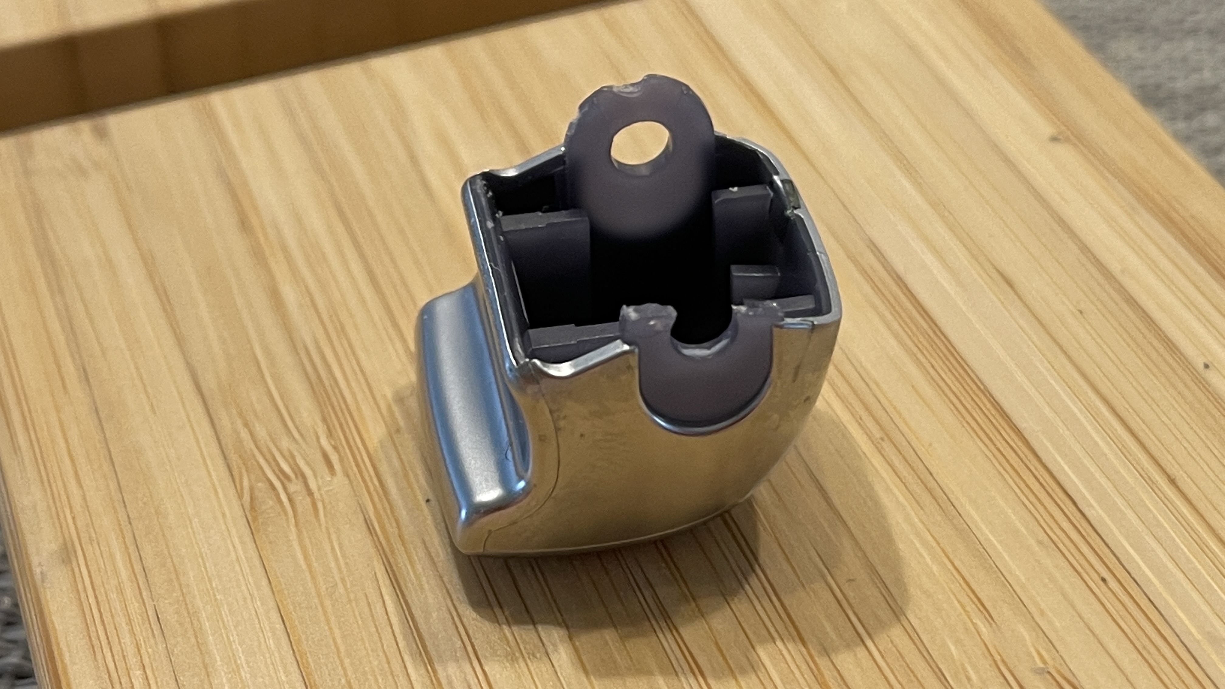

Throughout the history of Mercedes, I’ve always heard about how much detail they put into the design of their buttons/switches, right down to the A/C controls and all. I’ve been in numerous Mercs, and while I can say that the feel of Merc switches were superb, I can’t say the same for the W205. I start with this, simply because I’ve had to replace two broken window switches in a span of 6 months, and judging from the broken trim clip I found, this procedure has been done before on this 40,000km, 5yr old car.
You’ll find the offending part attached to this post, which is the same issue on both the master switch cluster and passenger window switches. I’m expecting the rest to follow.
