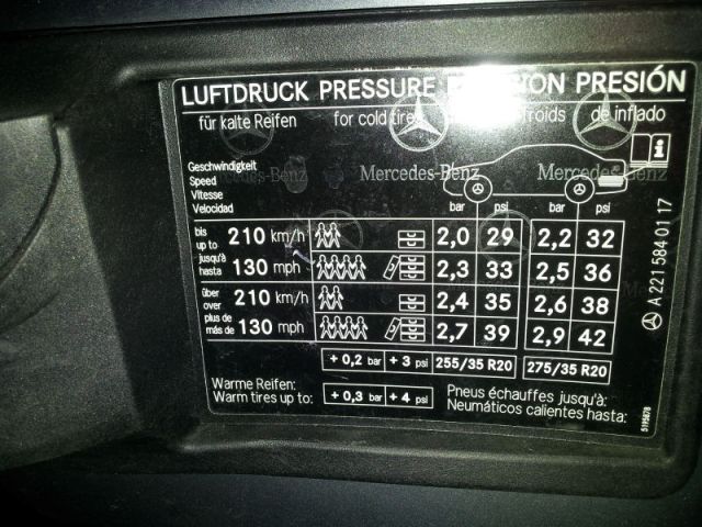

Check the fuel cover or door side?
There should be a sticker which tell u
Do you see this?
If you notice the below it says for 20inch add 0.2bar / 3psi.
The S350L stock tyre are 18inch thus you should follow that
