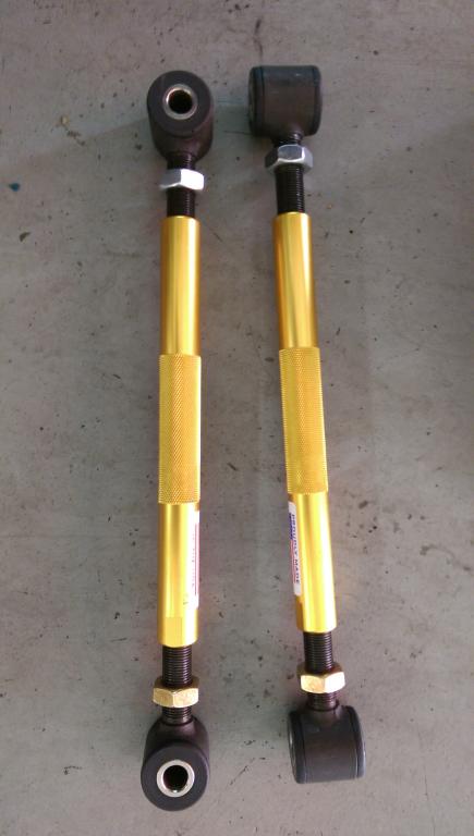

I think I bought the last piece. Don't bother checking out MB Arts..... no response to email and I read from MB forums that his stuff did not fit well.

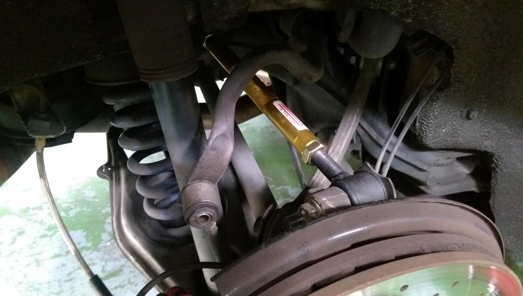

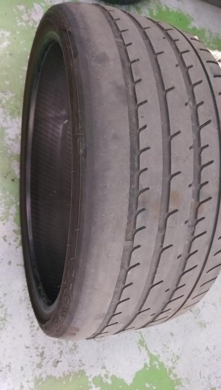

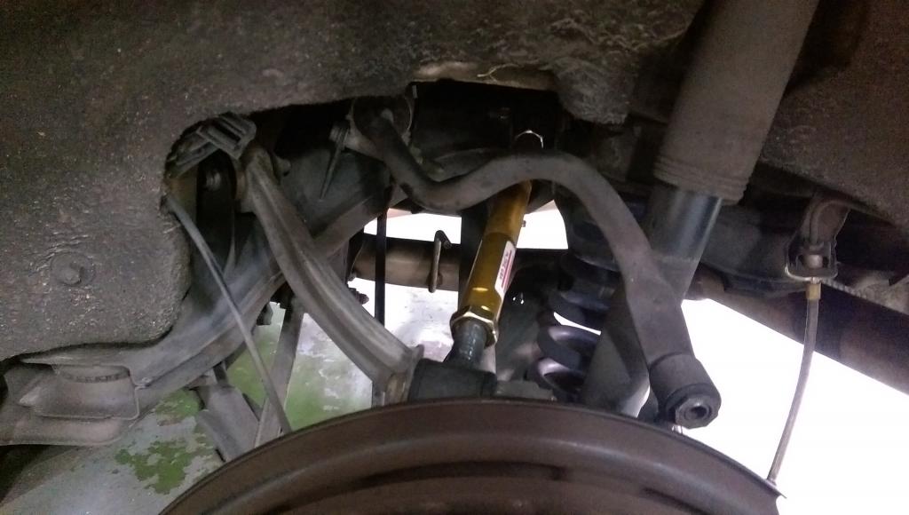

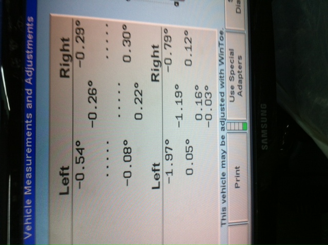

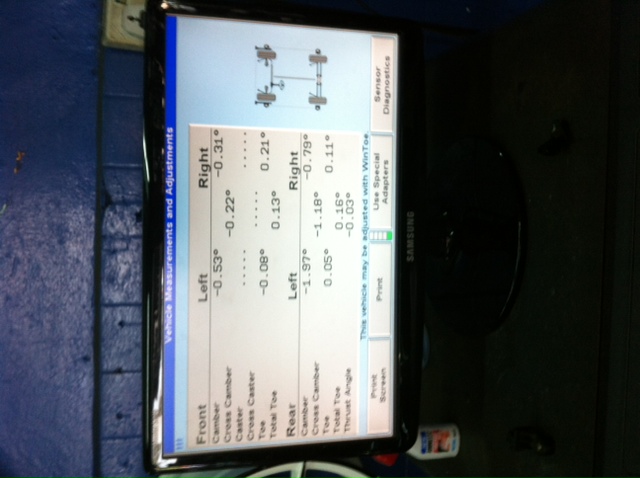

This one trial and tested and it fits. After lowering my car, from 2 degrees, I was running 3 degrees and my workshop did not tell me. Heart pain.. 20 inch tyres are not cheap and to have 2 shredded within 6 months is the pits.
