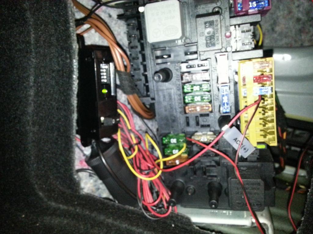

Super dl. Wat I mean is the power magic pro is unable to turn off, led always on. When I set the volt to 23 , the camera still can run happily when the car is parked. I drove back to rectify, installer still dunno Wat I mean. Haizzz. In the end I need to tell him one wire must connect to accessory fuse. Whatever the case now, one wire tap from iu wiring and another from the lighter socket in the glove compartment. Now everything seems ok but I m still wondering if he is tapping from the correct place. Shd have just gone to autospritze.

I tap from fuse at boot.
Red wire must tap to something where car on or off also have eletrical.
Yellow wire to cig where car off no electic. This will let your blackvue know that u are into parking mode.
Black wire ground.
I dislike figuring iu cable.
Hope above help u
And
U can try 23v again see if it cut power for ur camera if it does so it work correctly. Cause the main purpose if cut camera power
Photo ignore small red black wire. Thicker is powermagic pro wire
