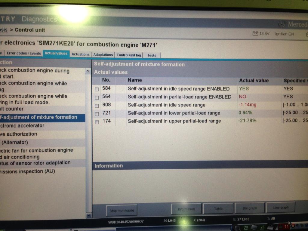

The below are the error readings. No error report on O2 sensor.
This error and loss of power did not happen on my decat or straight flow muffler, in fact i've been using my muffler for a year..
It only happened after the MKB module.. I'm surprised that no one else has this issue..

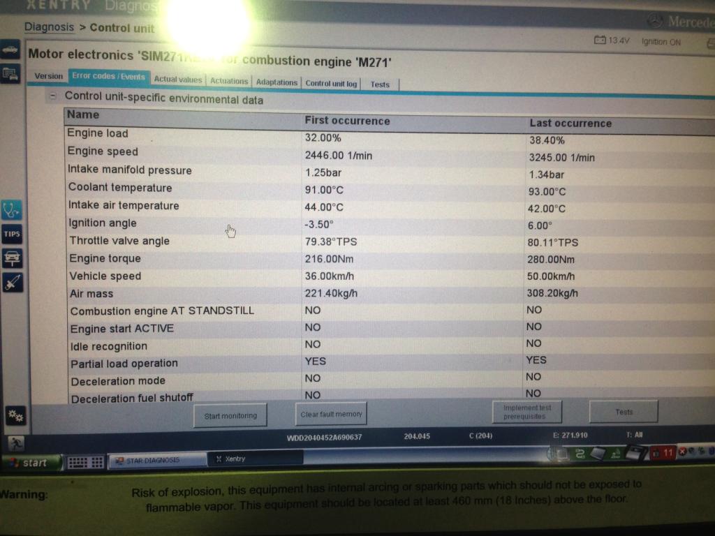

Also weirdly, after removing the MKB module, my boost as reflected in the pic below is still high at 1.3 bar!
It's not suppose to happen after removing it, but some how it feels as if the ECU adapted MKB's module and refuse to revert back to its stock setting..
Piggyback is plug and play, it will not overwrite your stock ECU. If you plug out the system and the problem still persist, it shouldn't be caused by it. I'm sure your installer would have also told you that. Your ECU should have "learnt" from the piggyback when its plugged in, give it a day or twos driving and performance will revert back to normal.
Send your car for a diagnostic check and you'll know straight away the fault. I doubt there's much any one here can help you with regards to pin pointing the fault of your car.
Thanks bro, problem is, at the diagnostic, it states boost pressure error. It immd only occured after the MKB module was installed and continued to persist after removing it.. I'm puzzled, drive for 3-4 days lieu, still same issue.
