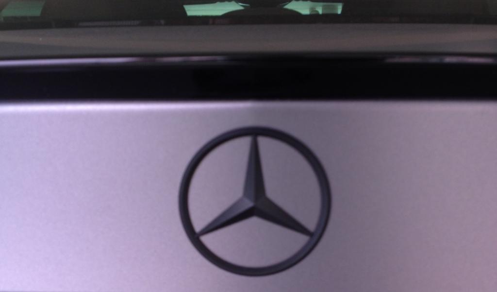

I just used plastidip to paint my chrome star emblem matt Black!

Get a few layers on it.
Each layer let it set for a few mins before applying the next layer.
When u peel away the excess, don't peel upwards. Instead, peel it side way.
Good luck!
