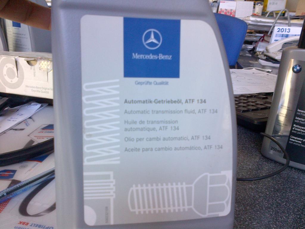

ER...you do need 8 bottles when changing ATF... I suggest you keep it.
BTW, this ATF is for 7G but can also be used for the standard 5 speed 722.6 Gear box
However, the standard ATF for the 5 speed is A001 989 21 03 10. essentially a non synthetic ATF
that only cost 12.50 a bottle.
