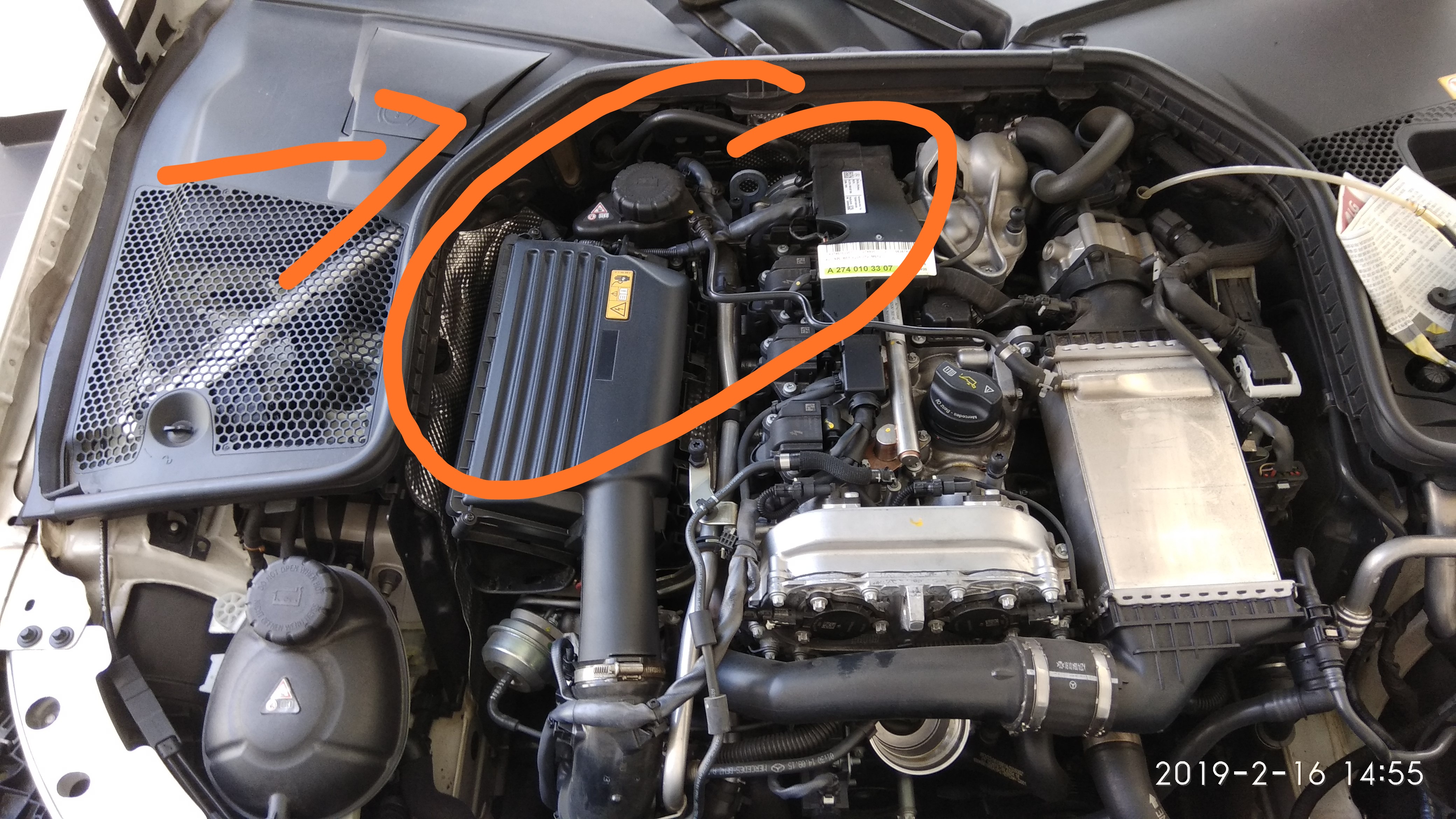

that bro, is also a coolant top up, but specifically for the turbo and intercooler cooling. there is a new revision to the setup in the W205, the newer version only has one now....
see my engine bay pic attached.

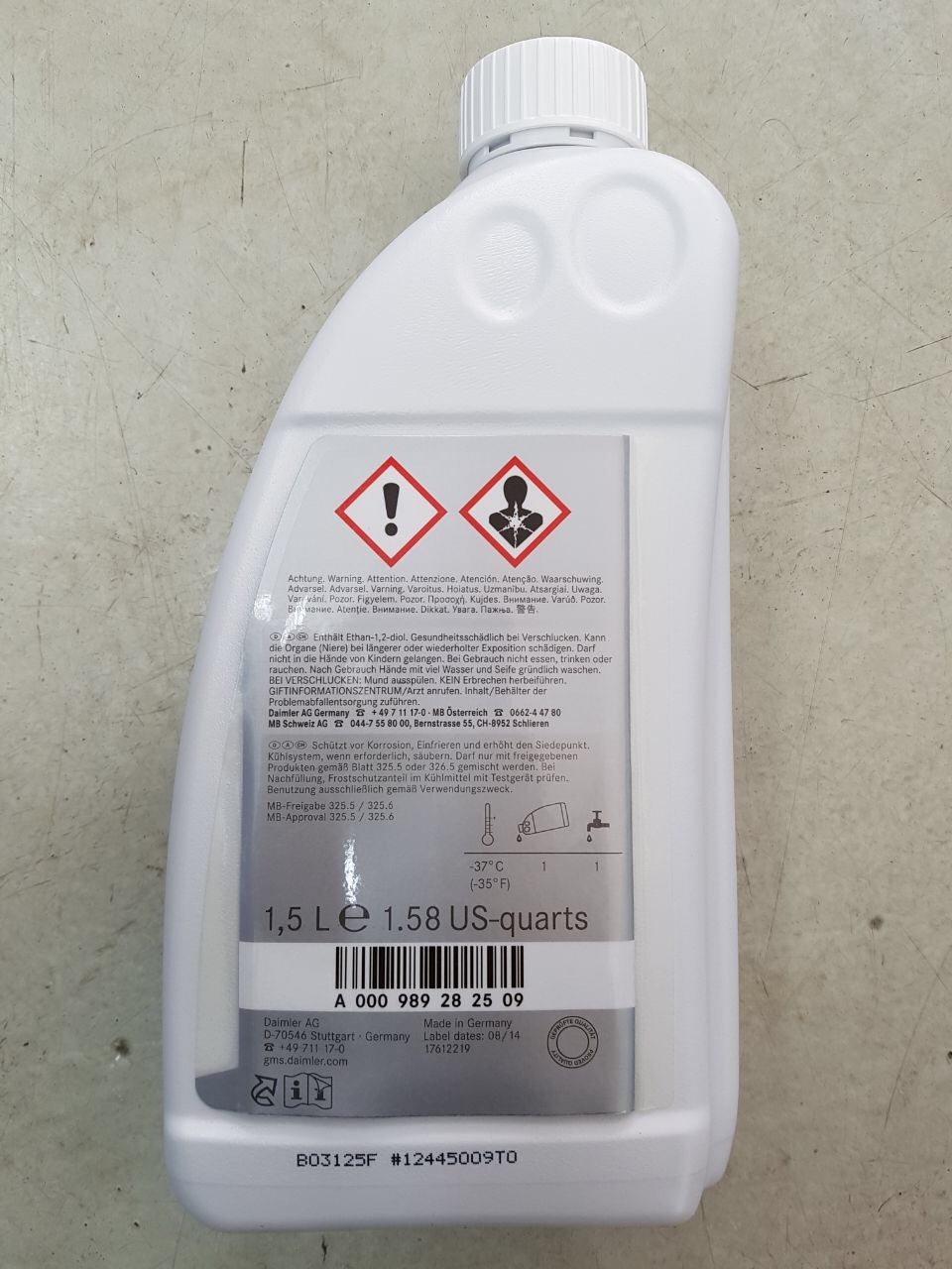

no, its the pink colored coolant.
it is classified as Specification 325.5, while the older blue colored coolant is 325.0
The part number for the coolant is A000989282509. You can get this from the stockist.

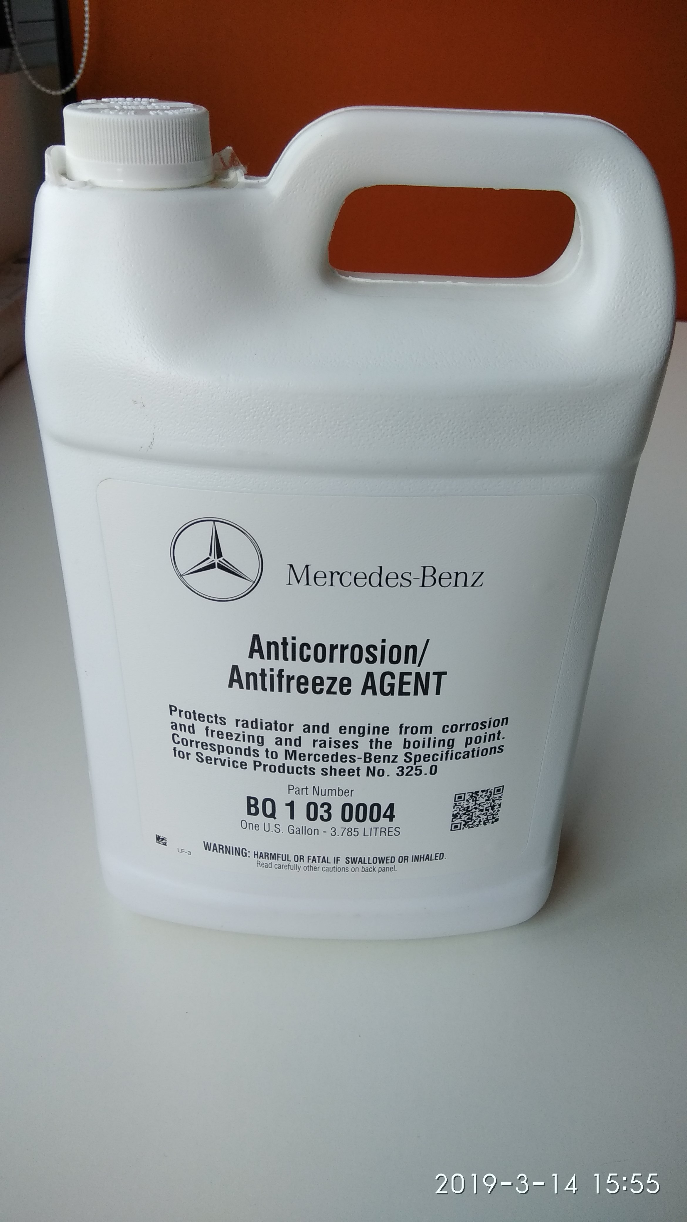

Oh dear / Oh shit.
Min Ghee sold me the blue one and I pour about 500ml into the reservoir as it was dry. I should have seek your advise before. Luckily I didn't pour into the turbo reservoir as I didn't know what was it for before your advise.
What should i do now?
